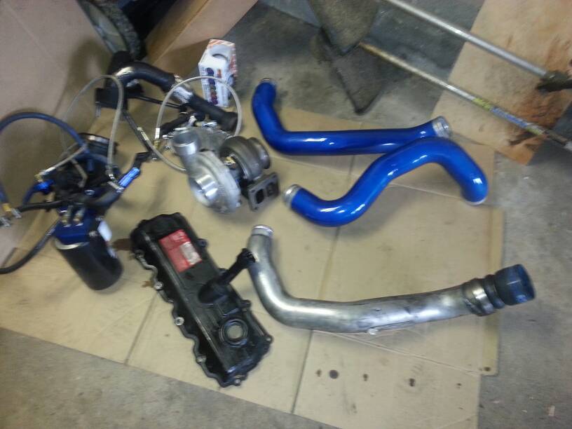

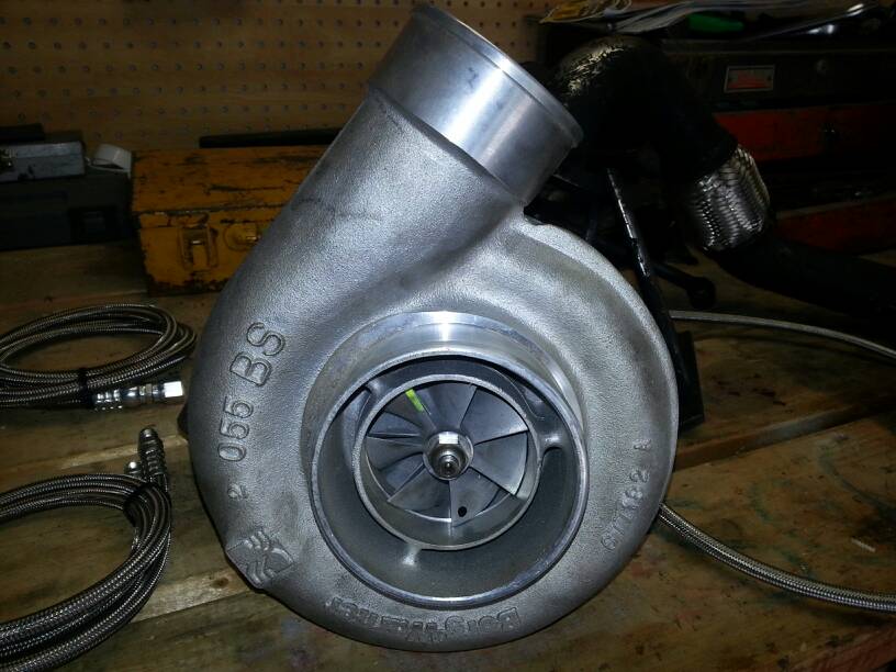

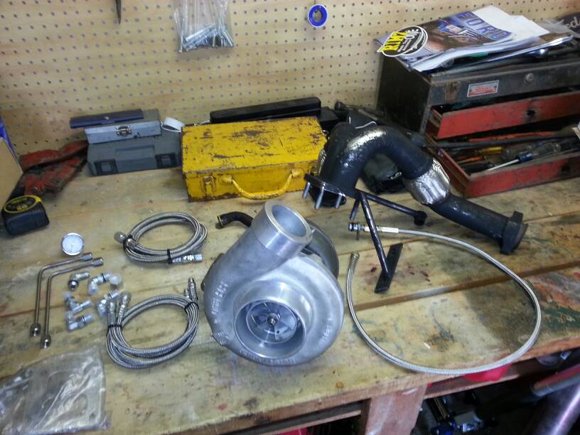

Started my build. Here is the parts list.
66/71/91
T4 divided up-pipes by Cutting Edge Diesel
Regulated Return
Warren 275/150 hybrids from Holderdown Performance
Aeromotive a1000

Also getting a sump. Just not sure whos. I might try to make my own intake elbow. With 03 cold side pipe. I cant justify spending the money for one.

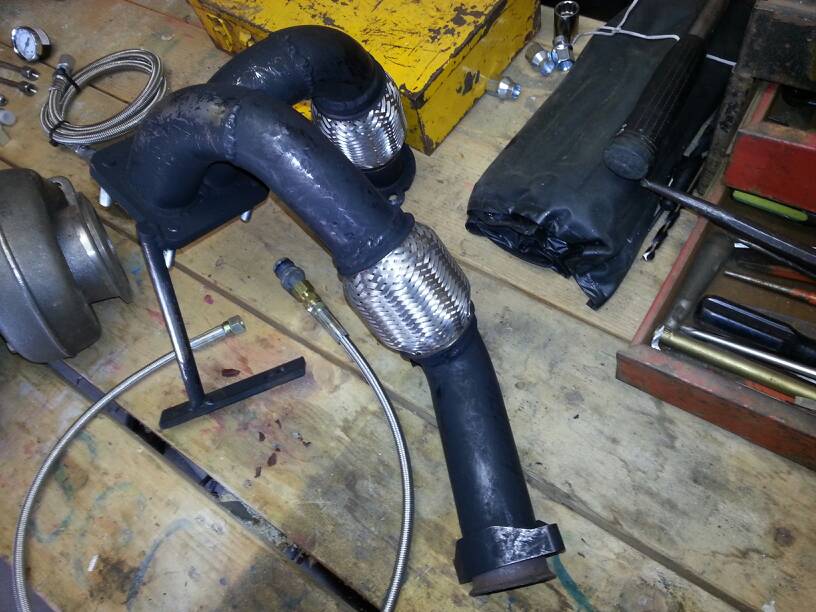

How easy is it to install the uppipes with only being one piece?
I know I can't get the stock ones out without separating them first.
Nice that there is one less place to leak from, thats for sure.
Looks like a nice buildup too.
strokethis_06
May 2, 2012
519
Got the up-pipes in. Ran into a problem. RR has a 90 on the back of the heads. Pipes would not clear the 90.

pull the pipes out and put the 90 fitting in first. screw it down then try. I can barely fit a pube between my fitting and pipes but they're in there.
