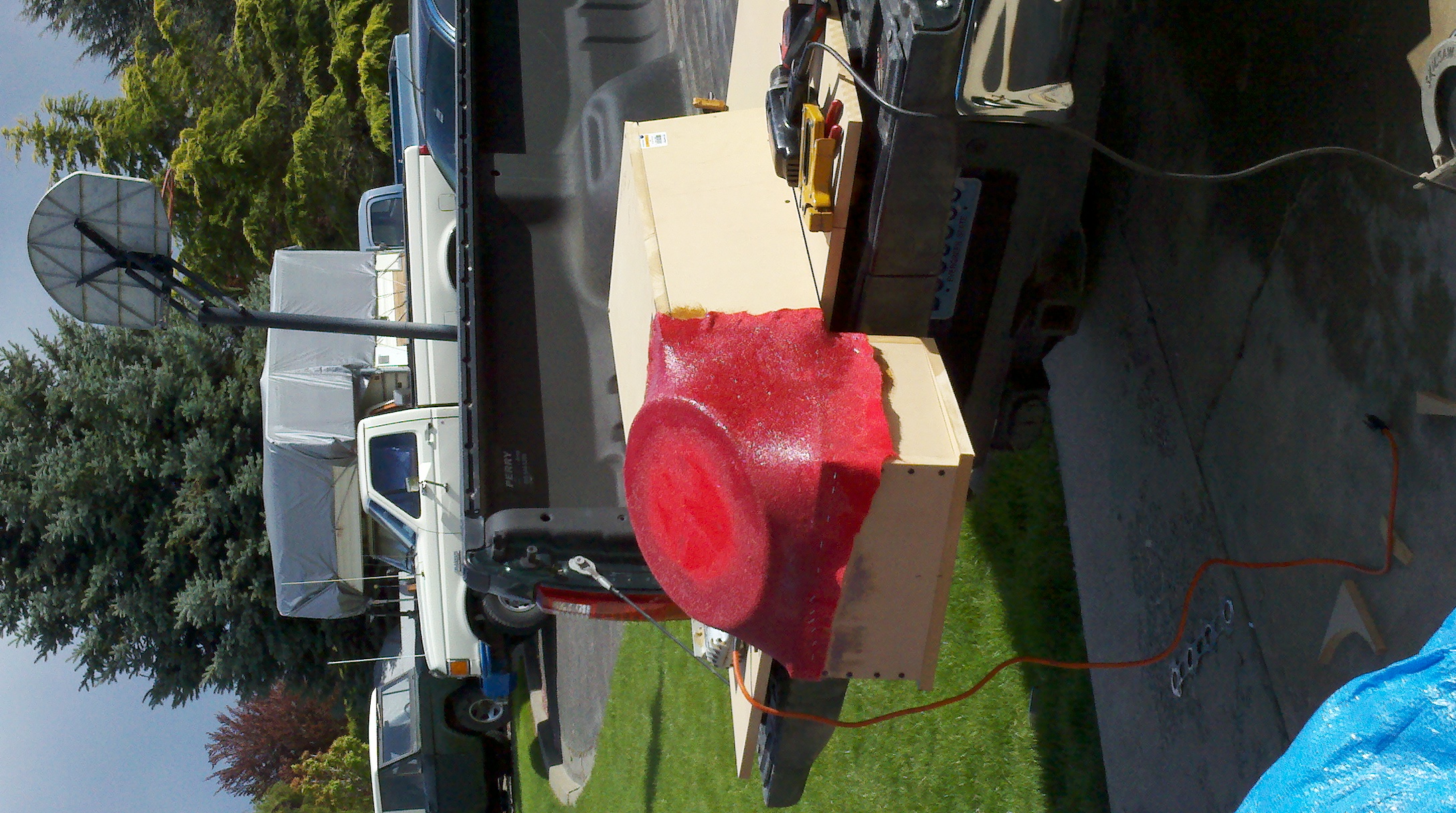

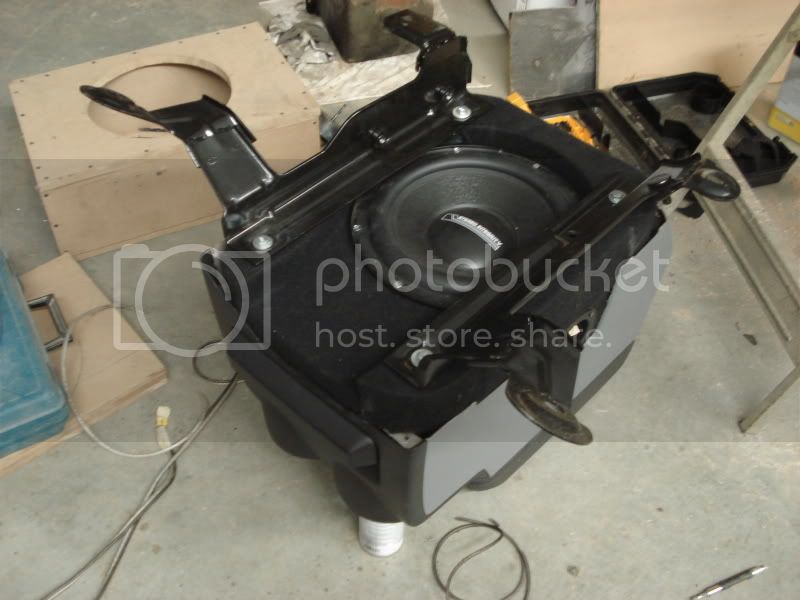

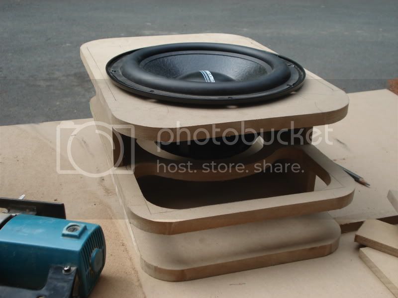

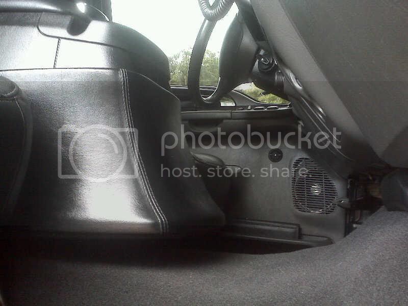

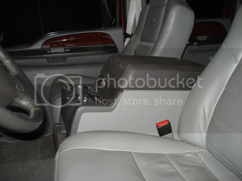

Yup I got tons of pics from when I built it.
This is the final product, it sits a few inches higher than the factor setups which I like, but I could easily drop it 2" without any trouble.
This is the skeleton inside before it got all wrapped and fiberglassed,
Cross section view from the rear, the bottom is the subwoofer box and the top is the storage compartment. Pardon the crappy fiberglass job, it all got worked out in the end.
underside, mounted using the brackets I had for my center jump seat
What this ultimately gives you is aproximately 0.93ft^3 with 7" of mounting depth, which opens up a wide variety of sub choices. Plus I still have just over 4" of storage in the top which for me is more than plenty.
there is also a guy on here, Snake, who has a pair of 10's in his factory 99-04 center console, a shop local to him built it. I don't know much else about it, but it just shows you there is room to work inside these consoles to make a pretty stealth setup.

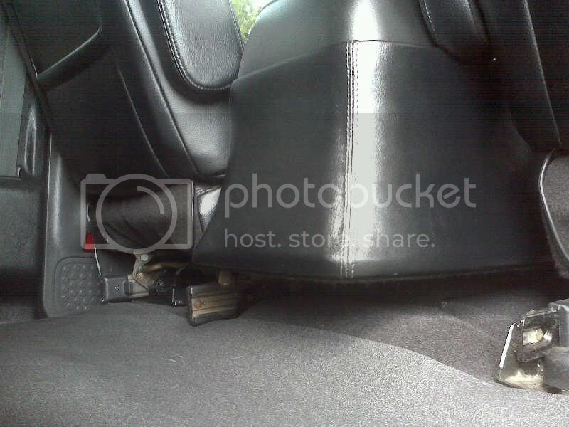

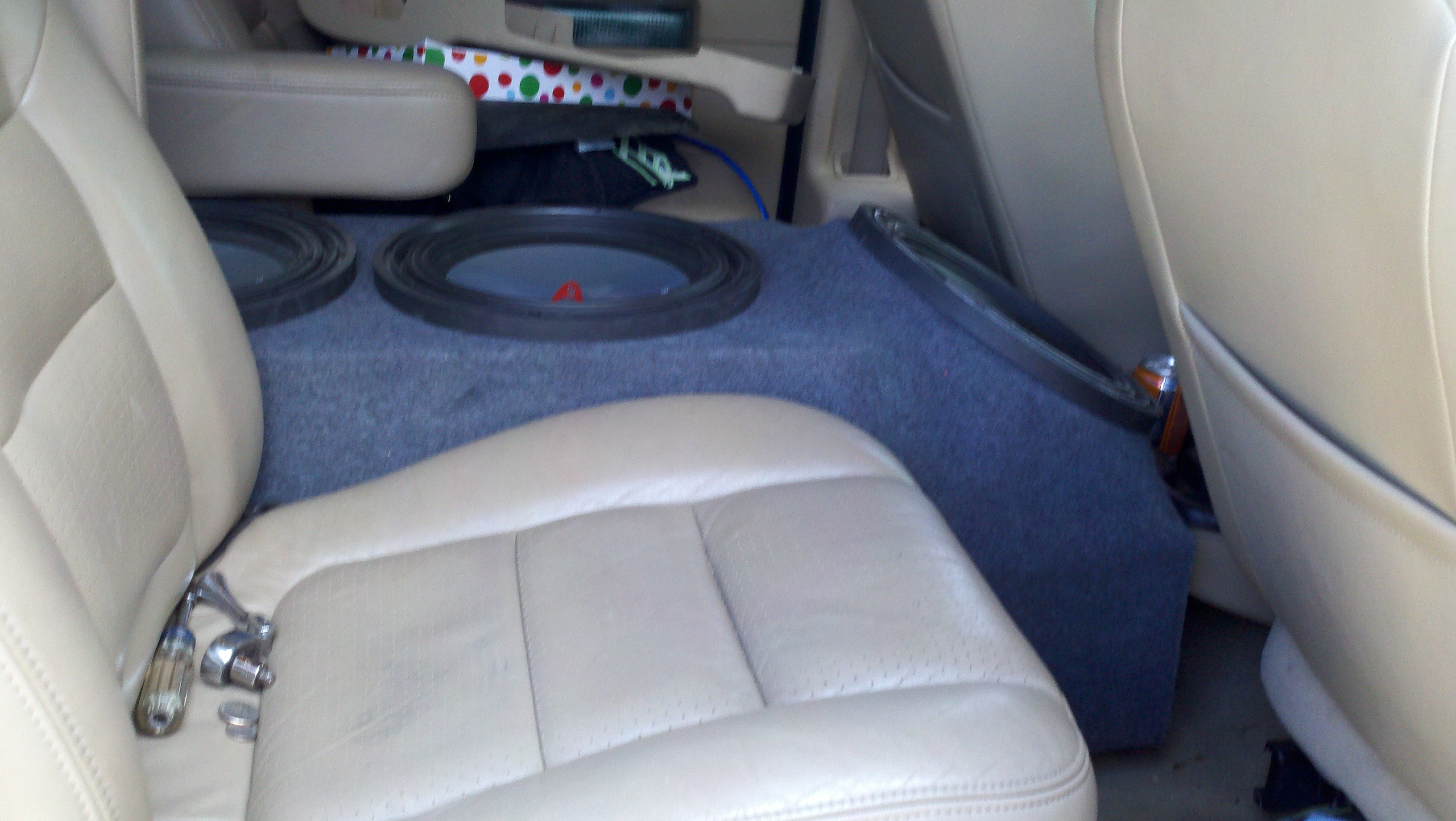

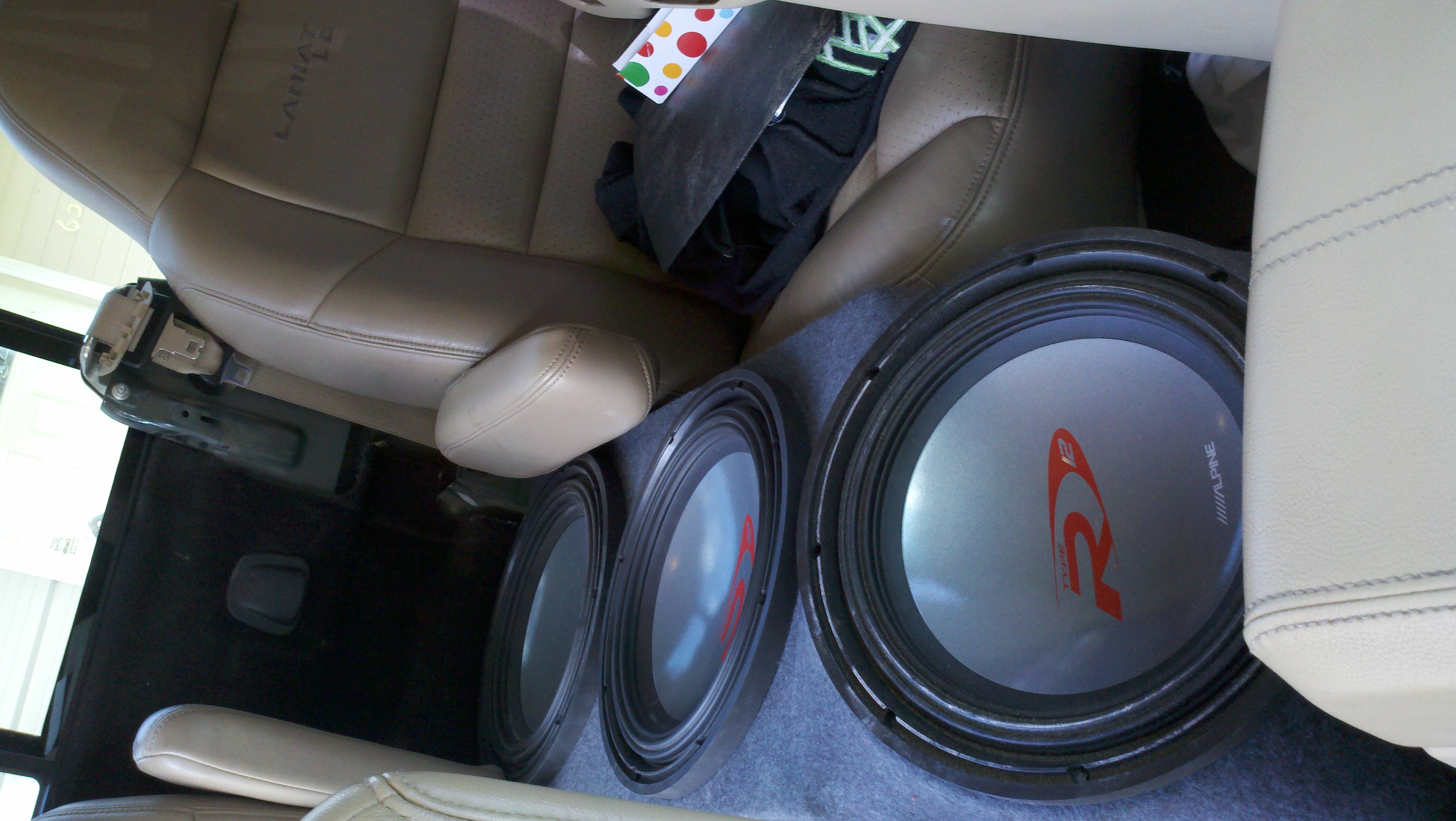

here is my 08 with captains. it kills your space but it was loud. overkill probably, i think if i did it again i would just do 2 12s

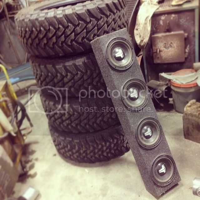

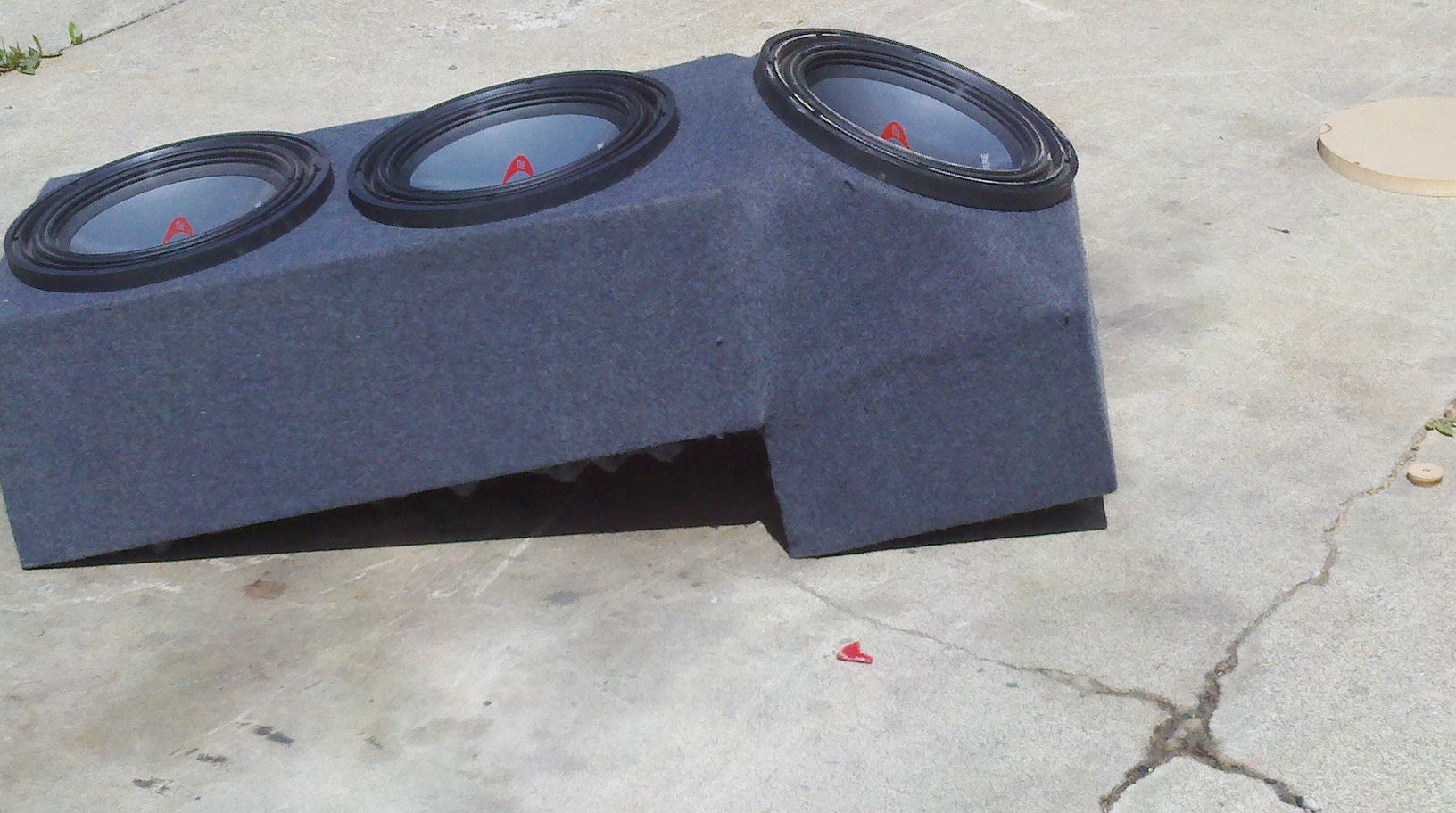

I did not. I actually have a small but long box with 4 JL 8" subs in it that I am going to try to make work when I get the truck back from the body shop. I'll dig up a pic of the box. It should work well I think.
Edit: Here is a pic

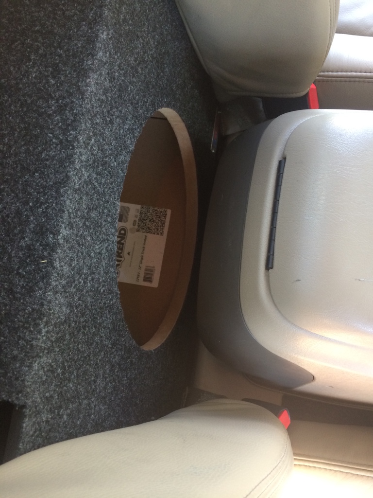

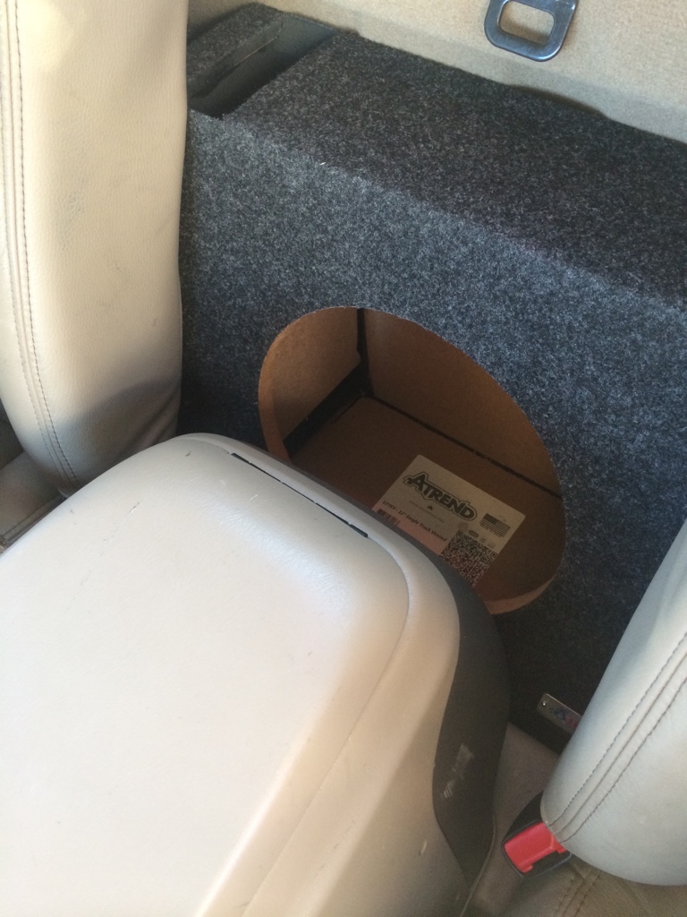

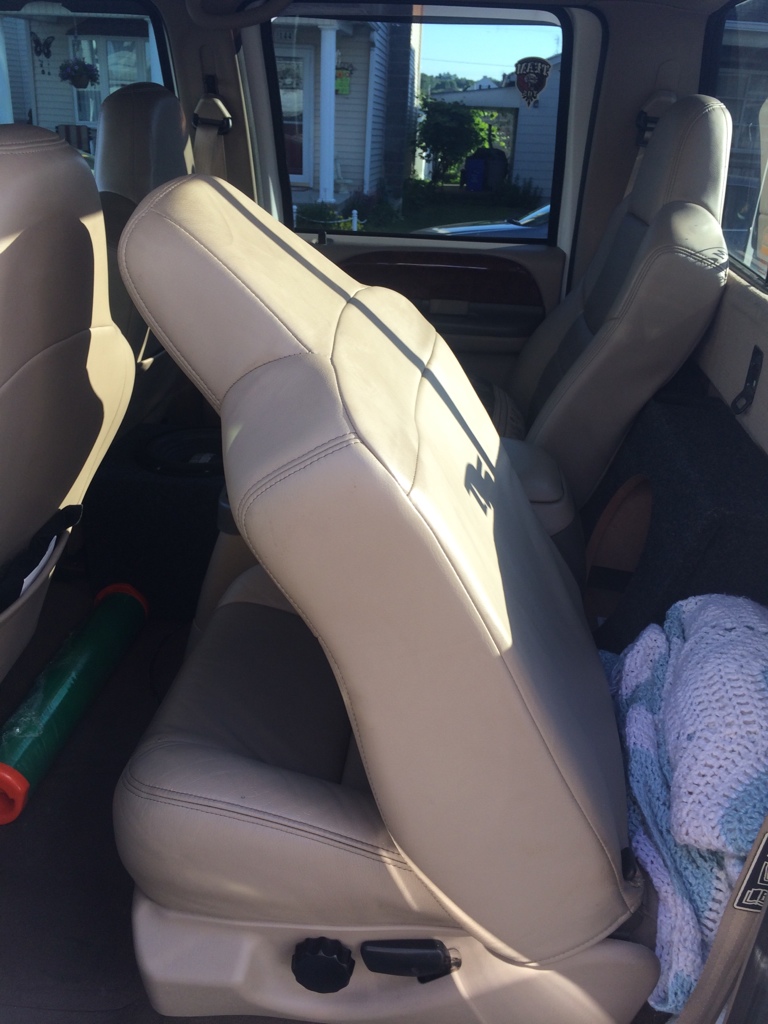

I have a box that fits. It's about an inch too wide though. Seats still go all the way back and it fits perfect. Just need a sub now.
This is the setup for now. Just blew this sub too.
