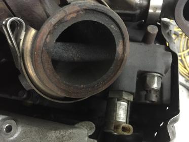

;) They seem to hold up better. Don’t know if I’ve ever seen one leak like the early version does.
Ive never seen one leak, but ive also never put one in the early spot. I always thought they leaked due to the heat/lack of a pressure drop at the rear of the motor, instead of where the late ones are mounted on the valve cover. Maybe it is just the early sensors are junk. Great tip though bud, never thought of doing that.

I’m sure the heat factors in. A lot of the early ones leak around the sealant. The late ones don’t have that sealant but rather more of a crimped together assembly. I think the crimped instead of sealant handles the heat better.

Regarding ICP sensors, I have put an early one on my 06 just to see how it performed. It held up well. Some of the late ICP sensor success is due to the location change, but no doubt it is a better built sensor and will hold up better in the HPOP cover location on the 03 and early 04 MY's.
