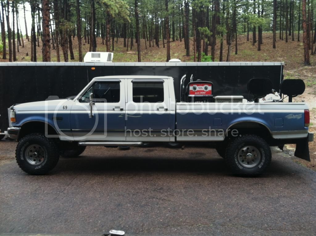

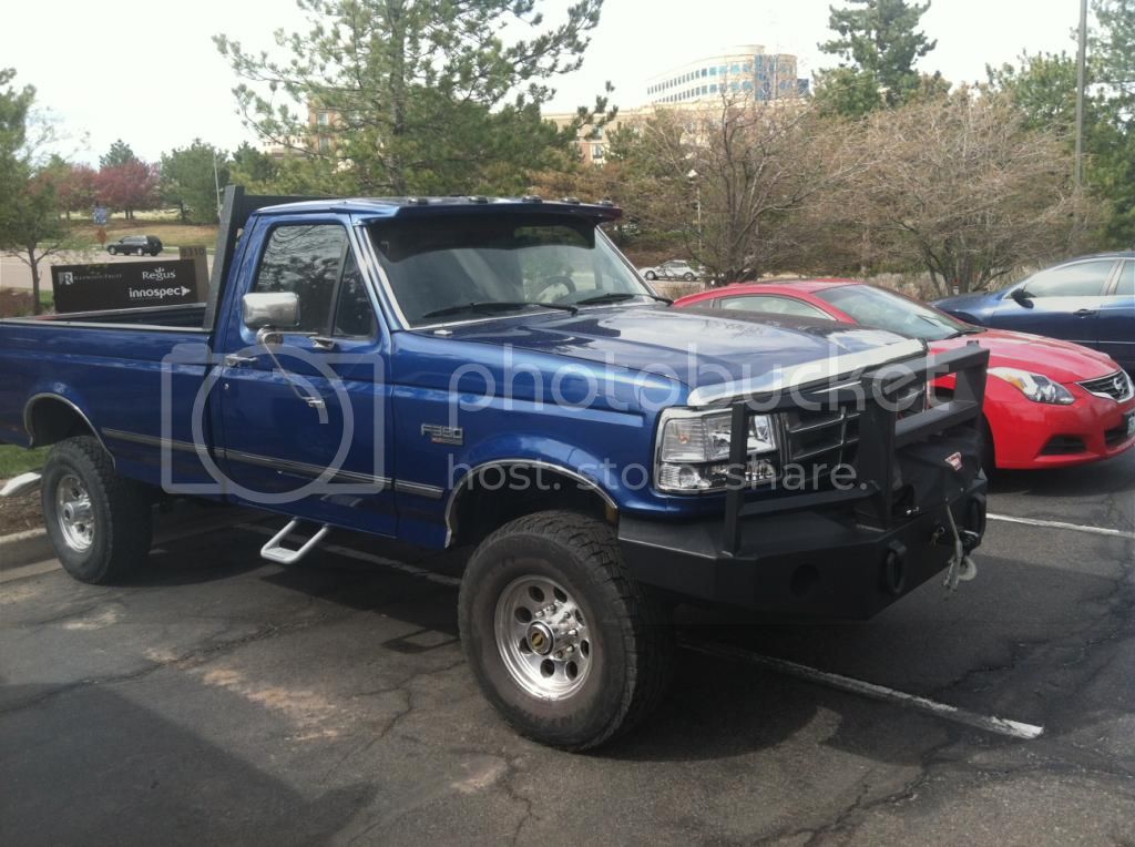

[QUOTE="nossliw, post: 1013049, member: 10001"] I run 285 on my 350 with no lift during the summer, 35's fit just fine even without a lift and are on my set of winter wheels. Installed a PMF RSK 2.5" up front and an Add a leaf and 5.5" Block in the rear on my friends welding rig that has 1500lbs in the bed at all times. Turned out better than I expected and would easily fit 37s or bigger. The PMF kit was as good as it gets for fitup, and worth every penny. Stock 350 with 285s [ATTACH=full]137188[/ATTACH] 2.5" PMF RSK with U codes off a 99 [ATTACH=full]137189[/ATTACH] [ATTACH=full]137190[/ATTACH] [/QUOTE]
