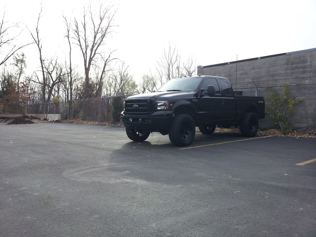

Heres a picture of the pig for those of you who haven't seen it...
