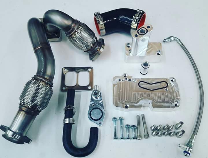

F25DY_Jake
Jun 2, 2015
61
Wilson, NC
Well got the kit in, looks awesome. Don't know if I'm suppose to get the boot and egr ****** hose? If so, I didn't. Here's a picture I found of the entire kit..
