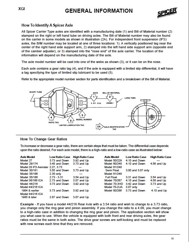

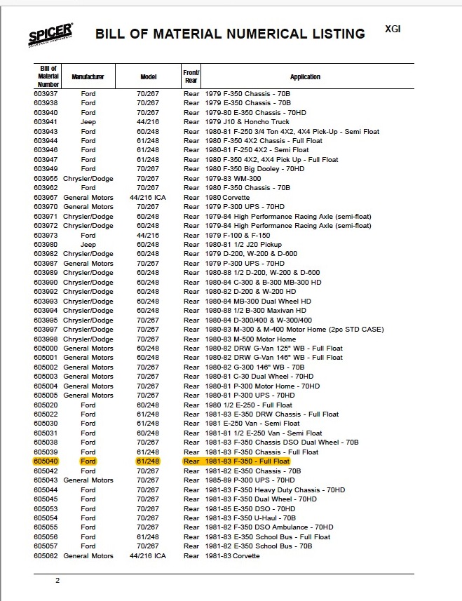

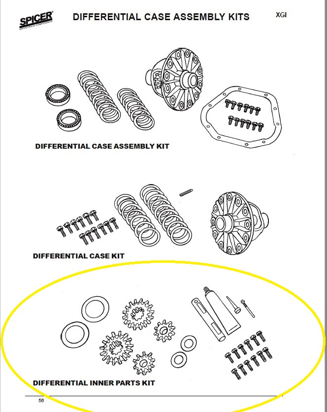

The # 605040-7 is the bill of material number & identifies it. I can't find a part number just for the pinion gears carrier pin but with the attached info if you contact Randy's ring & pinion or any gear shop they should be able to find it. If the pin bore in the carrier case is worn at all, then its junk. & a new pin won't help.

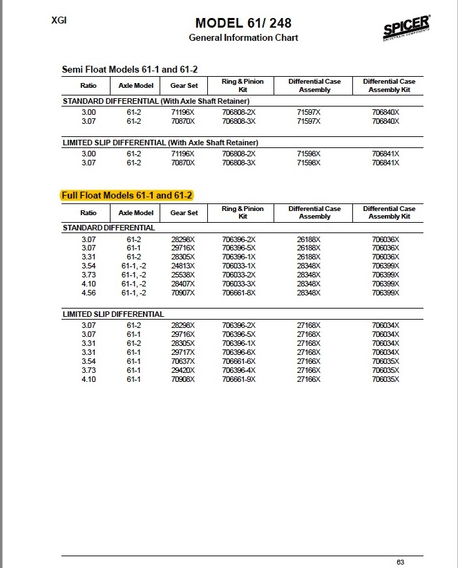

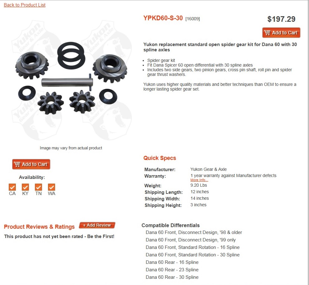

From the Randy's web site; This should be what you need, but better to call & confirm.
