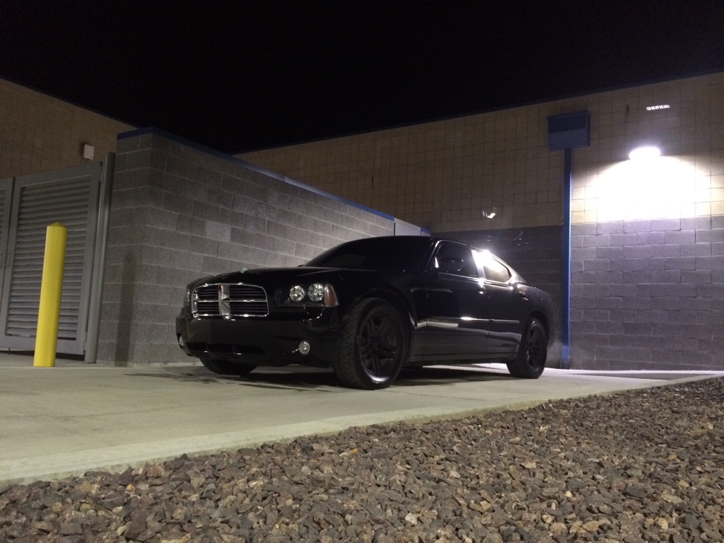

Whs^. I had the wheels done on my charger and I just used goo be gone ultra strength or something then power washed it. I had like 6 coats though. ImageUploadedByTapatalk1416058611.658031.jpg
