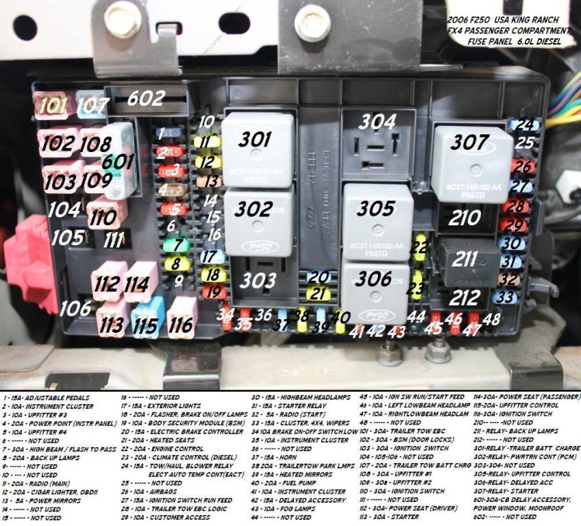

Wondering if anyone had any advice for this. I don't use this truck to really tow anything but it constantly beeps at me and says check trailer and tbc fault. I looked at the trailer connections and replaced the corroded ones but that didn't do it. There's probably water in the lines or it's shorting out somewhere. Is there anyway to pull a fuse or something just to get the dam thing to shut up. That beeping is really annoying. Also the last guy that had the truck installed an aftermarket head unit so i don't know if that has anything to do with it.

26 and 101 ?
