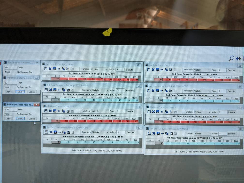

I'm trying to write a tune to lock the TC in 5th only in normal driving, but to lock 3rd through 5th in tow/haul mode. I've been playing with it for awhile with no luck. When using HOT mode like in the HS S1 and S2 files I have not been able to get the tow/haul function to alter in which gears the TC locks, so I tried using the EZ trans file, which does not use the HOT mode. Here's a screen shot. But still no difference in tow haul. This tune only locks 5th whether in T/H or not.
Maybe some other setting I'm missing? Or the speed ratio? Is it possible to run 2 different TC strategies in one tune with the T/H function? Any help is appreciated. Thanks in advance
