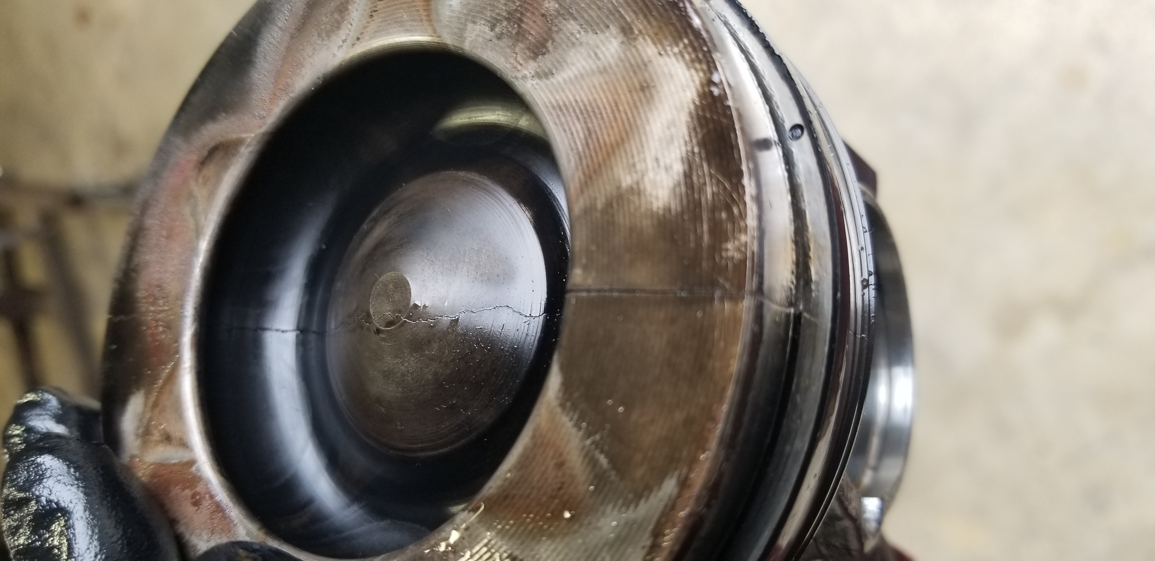

I've owned the truck since new.**Purchased in in December of 2009, at about the 50k mile mark I did that thing with the stuff and the computer thingy and enjoyed the truck.**Well here I am at 170k miles with two cracked pistons.**Number 2 and number 8.**Not really wanting a $700-$1200 truck payment I've decided to go the re-build route.

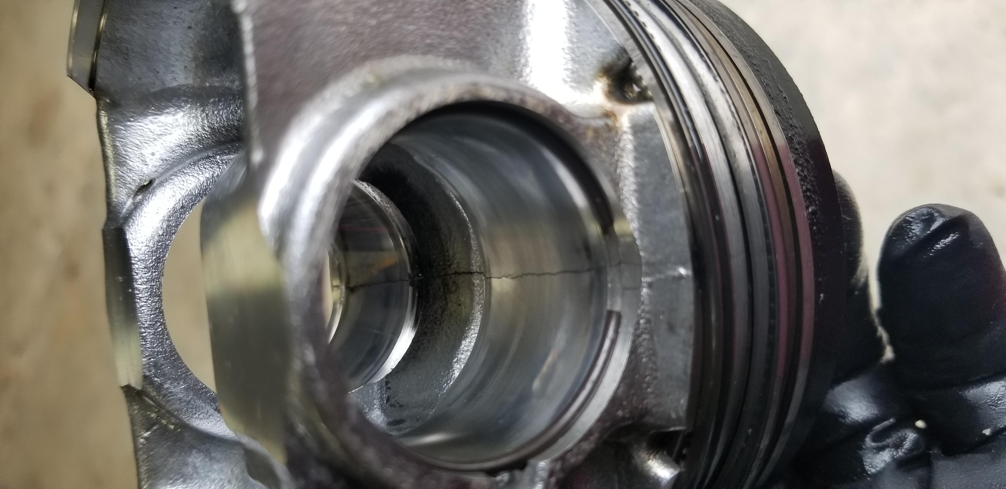

The carnage.
The piston pictured is number 8 which was the worst.
