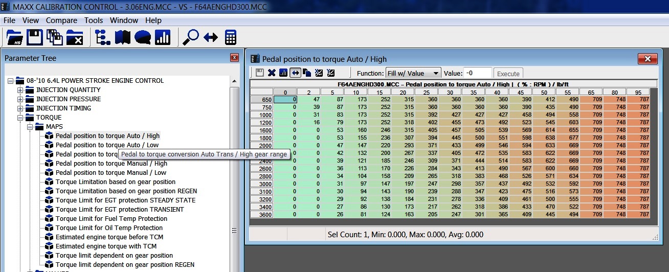

Can someone point me in the right direction to help me reduce the sensitivity of the throttle in the MCC software?

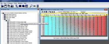

Go to TORQUE> MAPS> "Pedal position to torque auto high". Rather than change any of the torque numbers I just re-scaled the X axis so that it started at 5% rather than 2%. this took away the touchy off idle throttle, which is what I was after.
