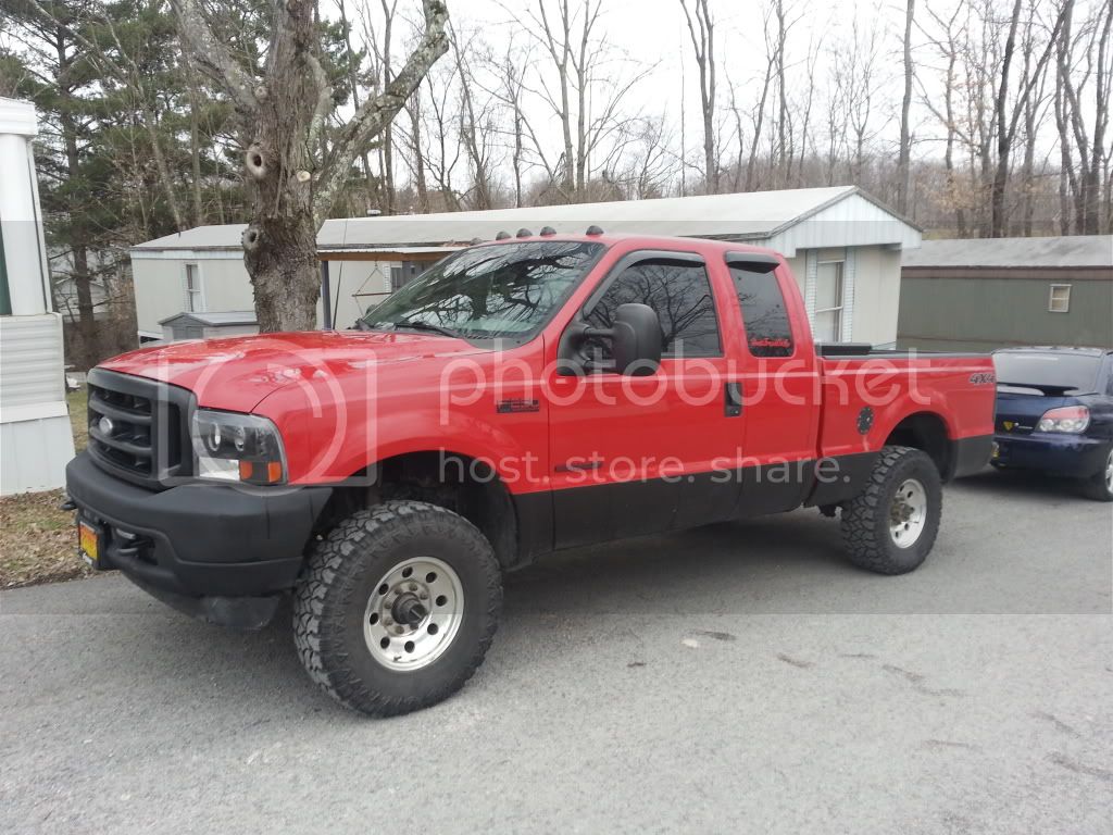

Ok so currently I have 285.75R16 on my truck now. I have a 2in RC leveling kit on it. I want to upgrade to 20x12 Fuel Octanes and 35x12.50 tires. First off, will it fit? I have seen many guys with 35s and leveling kit so i sure it will. I figure it will rub a lot. Second, I park in a parking garage. Right now I'd say I clear it by at most 4in. If I got 35s how much would it increase my height? Im thinking about an inch, maybe two. I probably sound stupid but thought I'd ask you guys first.
This is how my truck sits now.

Im going to say its not quite enough to clear.
I just put 315s on my truck with 4in hanger kit and I still rub the inner fender wells. I dont think my 16x10 wheels help though. I also do not think I got the full 4inches of lift because of the springs. I lost some of the lift due to the neg arch gained. I think I gained 3 inches but not enough. Supposedly 4 inches should be enough.

I say no go. You may be able to clear a 35 with some trimming but that 12 wide wheel is gonna kill you.

OP.... The 12" wide is gonna kill you unless it has one hell of an off-set. I have 315-75-16 Duratracs on a 16x10" and I had to pull the plastic fenders back to clear them, I did a 2" leveling kit plus x-code springs for 4" of lift in the front.

Thats not good. Im running the same tires with eagle 058 16x10. Im using a 4in pmf hanger kit and mine rub real good on the plastic inner fender well. Im hoping my new front springs will hel. If I would have known 4in was not enough, I would have got the x codes as well. Just went with v codes to replace my original springs.

Personally I love my setup. Only time it rubs now is when I have the 850# plow on the front and turning at low/slow speeds over bumps. Other than that, pulling the plastic inner fender back was easy. My truck is approx 1" shorter than most 4-4.5" "lifted" trucks.
