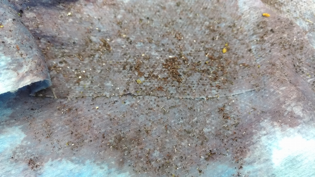

Transmission locked up in 4th or 5th gear. Not sure which, as the Edge CTS2 monitor gear display jumps from 1 to 5, or any gear in between.
Pulled the pan off, and checked six of the seven solenoids. (Did not want to pull the solenoid body off.)
Pulled the filter off, and dumped this out of it:

The pictures show brass. (Possibly)
I pulled and tested all but one solenoid, and they all measured good resistance. I didn't pull the last one, as I didn't want to separate the solenoid body.
