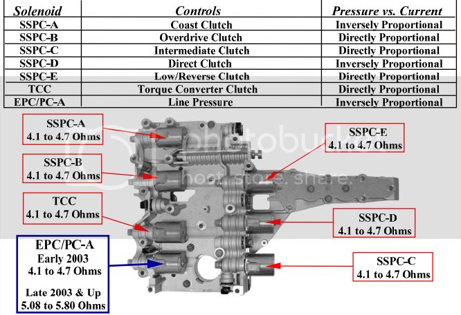

[QUOTE="Riverside, post: 921206, member: 12953"] Does anyone have the part number or something to identify witch solenoid controls TC locking and unlocking. Mine is having a bad day and the parts guys need a little more info to get me the right one. I know there are a total of 7 solenoids and 3 different part numbers 4 solenoids have part # - A. 2 solenoids have part # - B. 1 solenoid has part # - C. Witch one controls the locking and unlocking of the converter. Thanks [/QUOTE]
