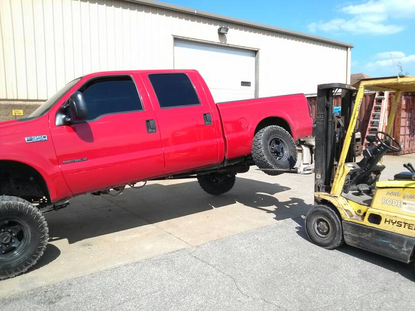

I did it exactly like I explained and my suspension is as if they weren't on there, besides the added traction and no more able wrap. Plus I still have plenty of articulation.
Sent from Prestige Worldwide headquarters!
