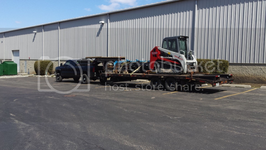

I have a 28' (23+5). I think I'd go longer then 30 if you want to put them both on there and have some room left. If you wanted to carry extra attachments you'd either be good at tetris to make them fit somewhere on the deck, or have a deck up on the neck to set a few things on. Also if you plan to have 16-20k on the deck plus the trailer weight (figure all of 7,000lbs for a quality trailer) I'd get 12k axles and electric over hydraulic brakes. Electric drums suck, poor excuse for brakes. I hate mine.
My 23+5. 10.5' snow box, 7.5' plow standing up right, 72" grapple bucket, 78" dirt bucket up on the neck, and the TL230 and 48" pallet forks on the rear. I think the only thing missing was my bale spears and boom lift, couldn't figure out where to put them safely so they went on another trip.

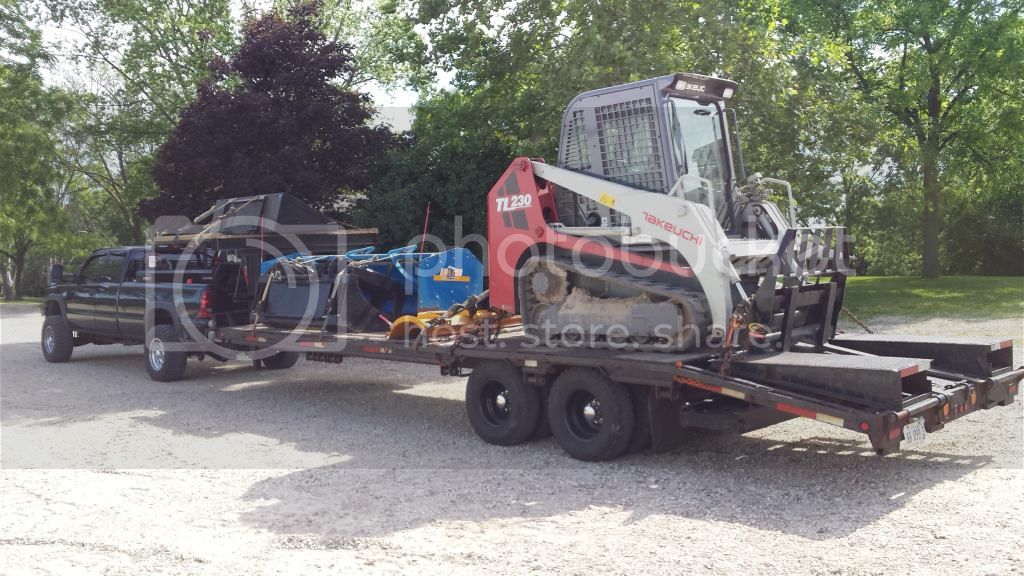

Same 23+5. The 10.5' snow box and my TL230.
