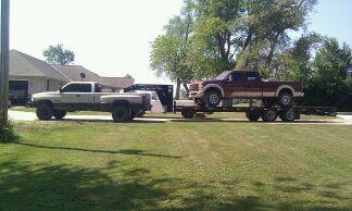

Well after much abuse my stock tranny finally crapped out. I will say that I was very surprised that it lasted as long as it has. The truck has been tuned and deleted since 8k miles with RCD 585 tune and for more than 6mo with Innovative extreme race tune. And of course all the supporting mods to go with. Ive sled pulled it over 2 dozen times and played around on the drag strip a few times.

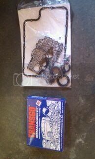

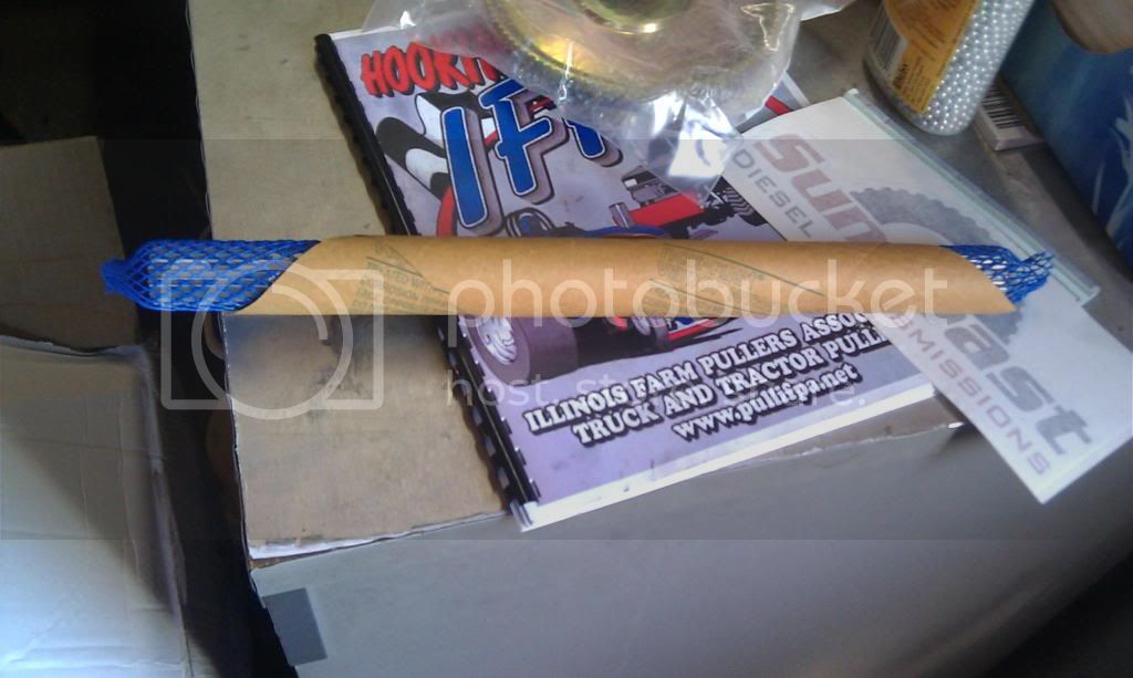

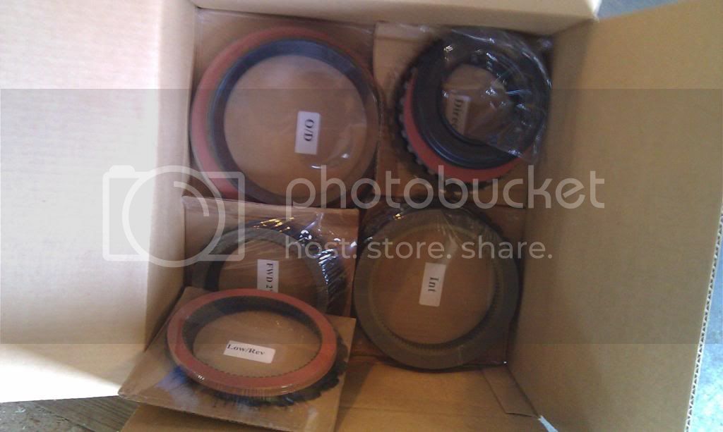

Called SunCoast and got there entire rebuild kit plus triple disc convertor, billet input, billet low-reverse hub, billet flex plate, deep pan.

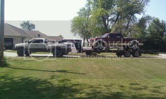

The ride of shame. Lol well glad to see your getting it all back together better than it was
Go ahead and laugh. That old dodge is the best truck i've ever owned. It gets the hell beat out of it and its guts pulled out of it every day. 350k miles and still going strong. I'd really like to see these new trucks last that long with zero motor work and only a clutch, big input, and 5th gear fix.
But I see what your saying, since this is a ford site and all.
My tranny guy says it will be done by the end of the week so I'll see what a built auto feels like.

whatd that rebuild kit cost you? I've got a suncoast triple disc installed right now, but want to build up my internals
If I remember correctly it was $980 for the kit.
