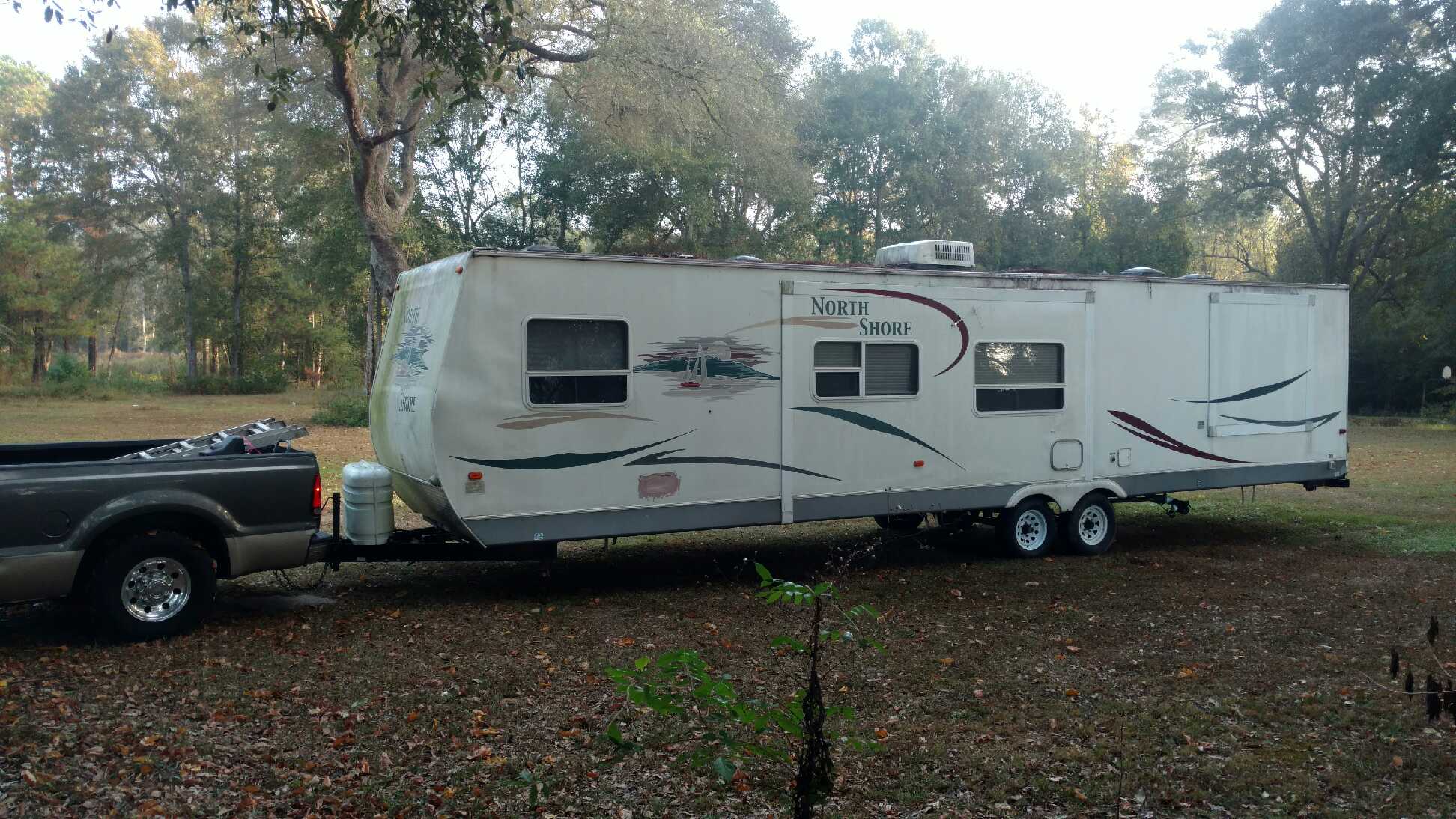

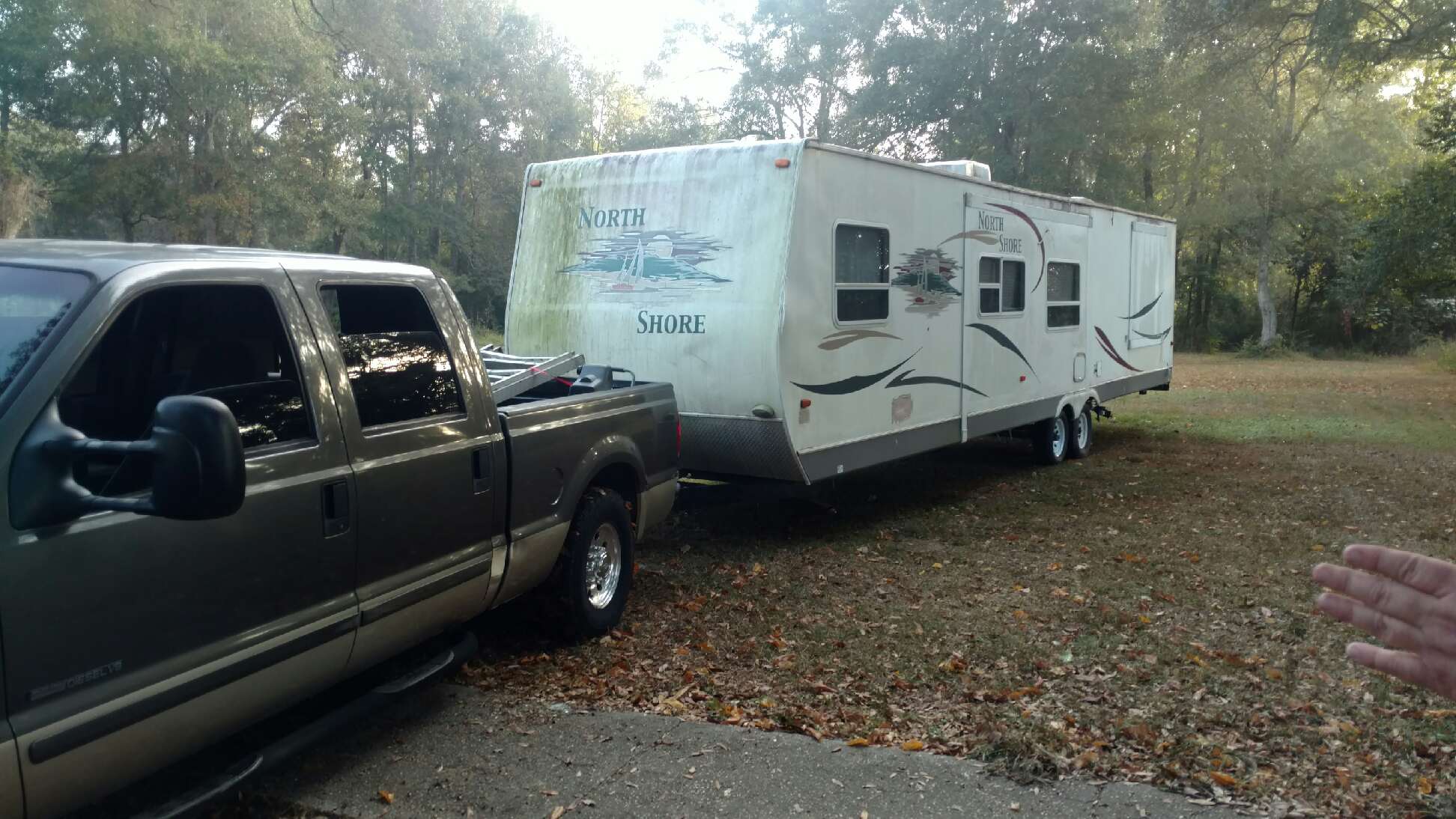

My heaviest tow was this morning and I was expecting a little more from the truck I guess. I usually have a quad in the bed or a small utility trailer with a couple 4 wheelers. Someone needed a travel trailer moved a couple miles so I didn't mind helping, plus that's what the things are made for.
It had 2 slides and the gentlemen said it was 40ft long and I don't know what the weight of it was. I looked but couldn't find a tag I was curious. It did have some furniture in it luckily I didn't have to get on the interstate with it.
I don't have guages (next project ) truck is 02 intake exhaust and tuned on dyno by php. I had truck in my heaves tow tune just thought it would have pulled easier.. Maybe this is normal I just don't have anything to compare it to. Just a little bummed I guess.

I know it's not much but the biggest I have pulled.

maybe the brakes were dragging?
I was wondering that but noway to really know I don't guess. It had been sitting for several years in one spot. I had to air up all the tires once moving it seemed to coast OK but hell something that heavy once moving would seem to roll along ok.
Maybe it did pull it OK and maybe I was expecting to much. I wouldn't want to pull that on the interstate very far I don't think it would pull it in od.

Forty foot trailer, especially an older one could be as much as 16k.
That's a lot of weight for a near stock 7.3, powerwise.

The camper has 6 lug axles . I think the highest I've seen 6 lug axles rated for is 5k. So it's probably gvwr of 10k tops, which means it may weigh in around 8-9k. There is a whole lot of @$$umining there on my part but I believe it's a fair guess .
Secondly, do you have gauges? If so........
Heavy tow is generally derated, a lot! Depending on your trucks setup and other mods and your ability to watch gauges, I'd probably run the standard tow file, unless you noticed you had to watch your gauges too closely.
Just my .02

For some reason I didn't think this was the trailer in question. If it is....
Just my .02
I'd agree here.
Heavy tow is only about 25 hp more than bone stock, give or take a bit. Err on the side of caution for the guy with no gauges and a heavy right foot, lol.
With gauges, and attention you should be able to pull that in a light tow, or even a mild "hot" tune, depending on the mechanical condition of your rig.

Thanks for the replys guys. I have no guages, I really need to get some I usually ride empty but if I had to pull like I did I would have them on there quick. Still need them because I don't have a clue what the truck is doing or may be needing.
Truck is a 02 cc stock size wheels 3.73 stage 1 injectors bone stock trans. Truck made 381hp 870ft on the hottest tune. My heavy tow is 25hp next tune is 45hp they go up from there all the way to a 140hp extreme. I have a mbrp 5in exhaust and a tymar intake that's it. The axles on the trailer were 6 lug and the tires had 50 psi in them. My truck was really abused by previous owners and I baby it for the most part like on the interstate I try to keep it around 65mph.
