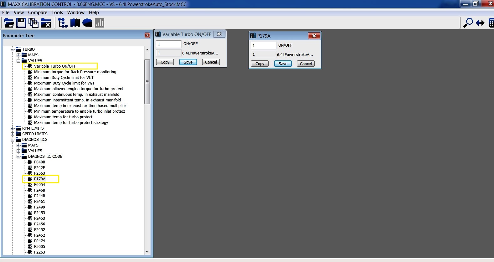

I have a 08 6.4 with a signal turbo and I keep getting this code is there any way to stop it

If you have an H&S & MCC you can turn off that parameter & the Variable turbo function that controls the actuator.
If not, whoever wrote your custom tune for the single turbo should be able to help you with this.

You would need H&S's Maximum Calibration & Control programming which would give you the ability write custom tuning for your mini max.
Contact some of the Vendors on this site & they should be able to get you set up.

can anybody tell me how to get into the parameter tree so I can turn off the Variable turbo function that controls the actuator thank you
