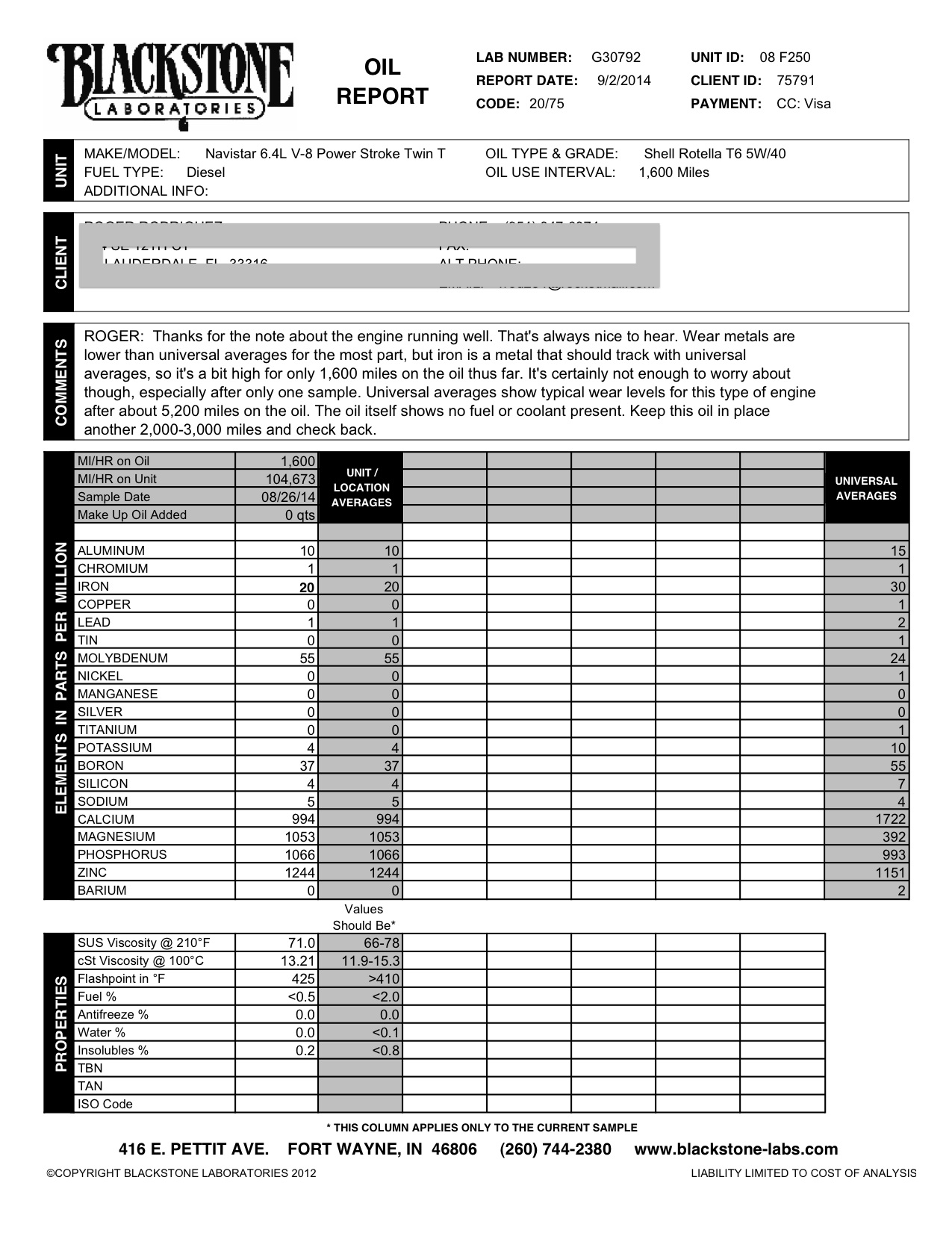

A side note I literally just received my black stone oil report and everything checked out phenomenally. Not a trace of oil or fuel in the oil. How can I have blow by if fuel is not getting into oil? Is that possible?

I have attached the blackstone report too. The oil report honestly makes me feel a lot better that my engine isn't coming apart internally and metals are't floating around all over my engine like the first mechanic claimed to have noticed. According to oil report the engine looks pretty healthy..
