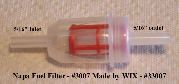

I removed the screens installed the tubing, and instead of a lift pump, I just kept the stocker with a inline filter just before the pump. NAPA 3007 around $5

Well guys, I'm back up and running. I ended up changing things a bit. I ended up using a Wix 33003 instead of a 33007, a 5/16 filter didn't make much sense with a 3/8 line. I ran the 3/8 line from the tank, the 33003 filter, holley blue, some more line, to the stock pump. All I can say right now is WOW! It seems to run much quieter, and smoother. I won't say it added any power, but it seems to have made the truck easier to drive. I was in a hurry to get it put together today so I'll get pics in a day or two.
