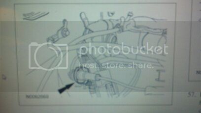

Wire located just below the ground wire on the pass inner fender. Unplug it and touch it to the hot post on the battery it will crank if the battery is up. You will have to fish it out to get slack or use a jumper. After you crank it it should be fine and crank by the key, mine has done it twice. here is a pic see arrow

I just got a charger and hooked it up and the interior lights were all brighter and it started right up. I unplugged the charger, and started the truck back up and it read 12 volts. Anybody recommend a good couple batteries? Thanks for all the help guys. I appreciate it.
