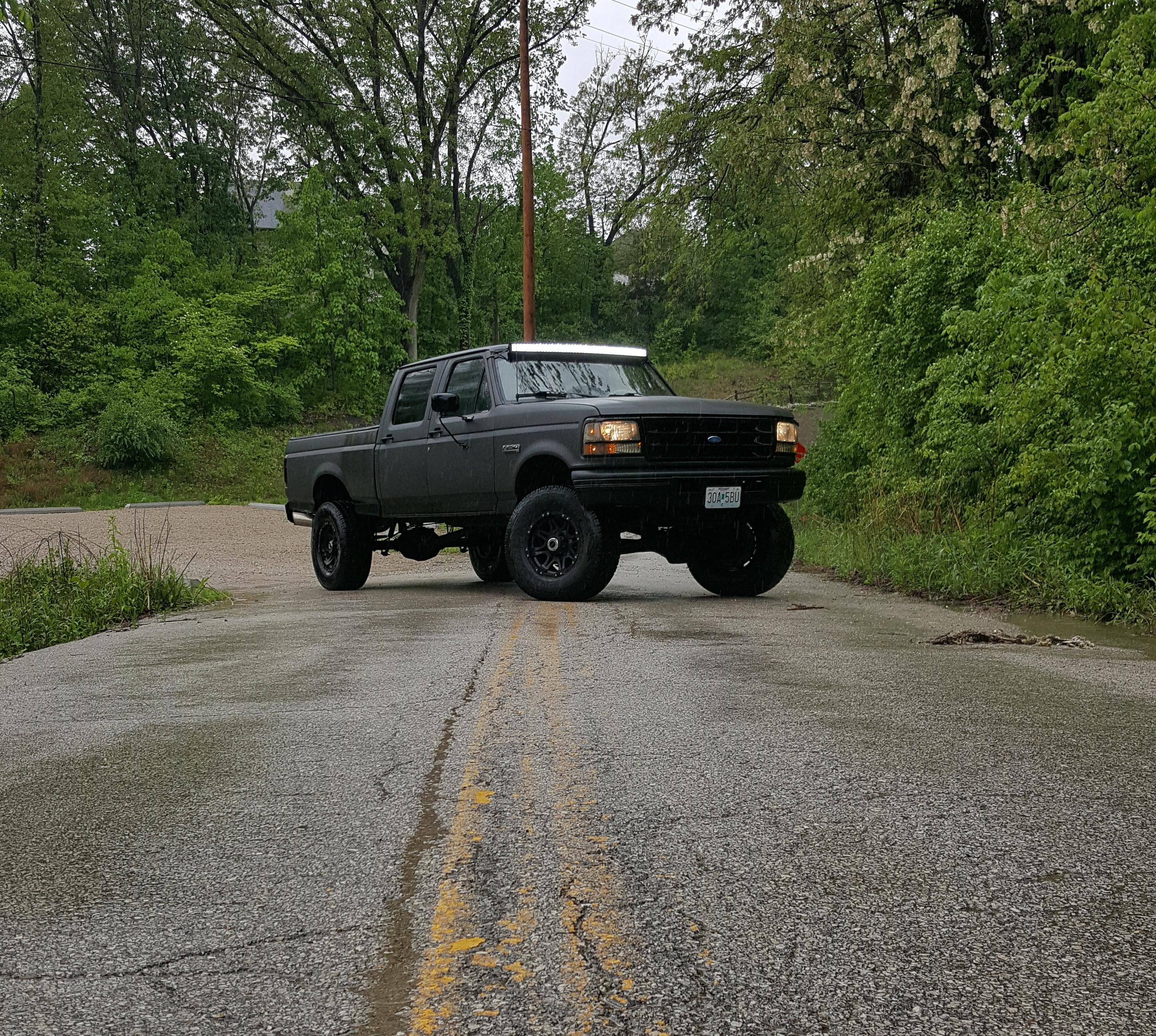

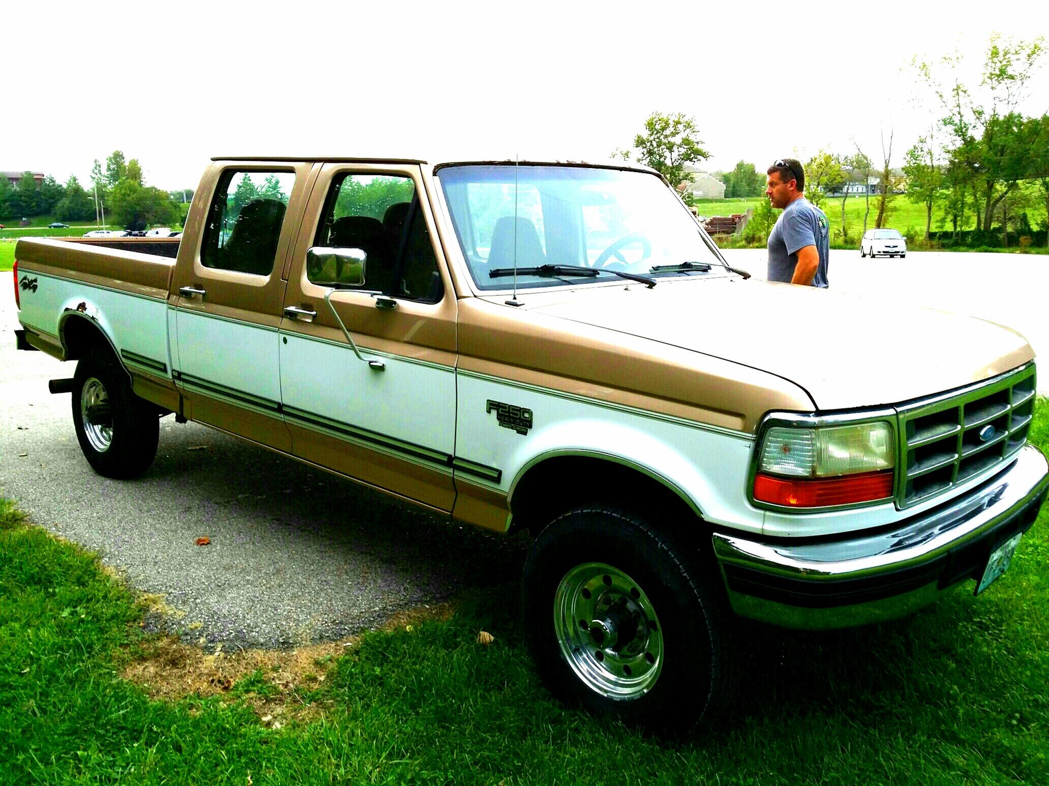

I guess I'll show you guys my 97 ccsb f250 4x4 build so far. When I was 14 years old, my dad and I were kind of looking on and off for a project car for me. We ended up at his best friends junkyard one day, just to hang out and talk to his buddy, but in the yard about 200 yards away I could see an OBS sitting. This wasn't a junkyard most people think of, it's a tow lot, then he sends them to be scrapped. This f250 powerstroke 4x4 was abandoned and had a salvaged title, he gave my dad the title and keys a couple days later and the build began.

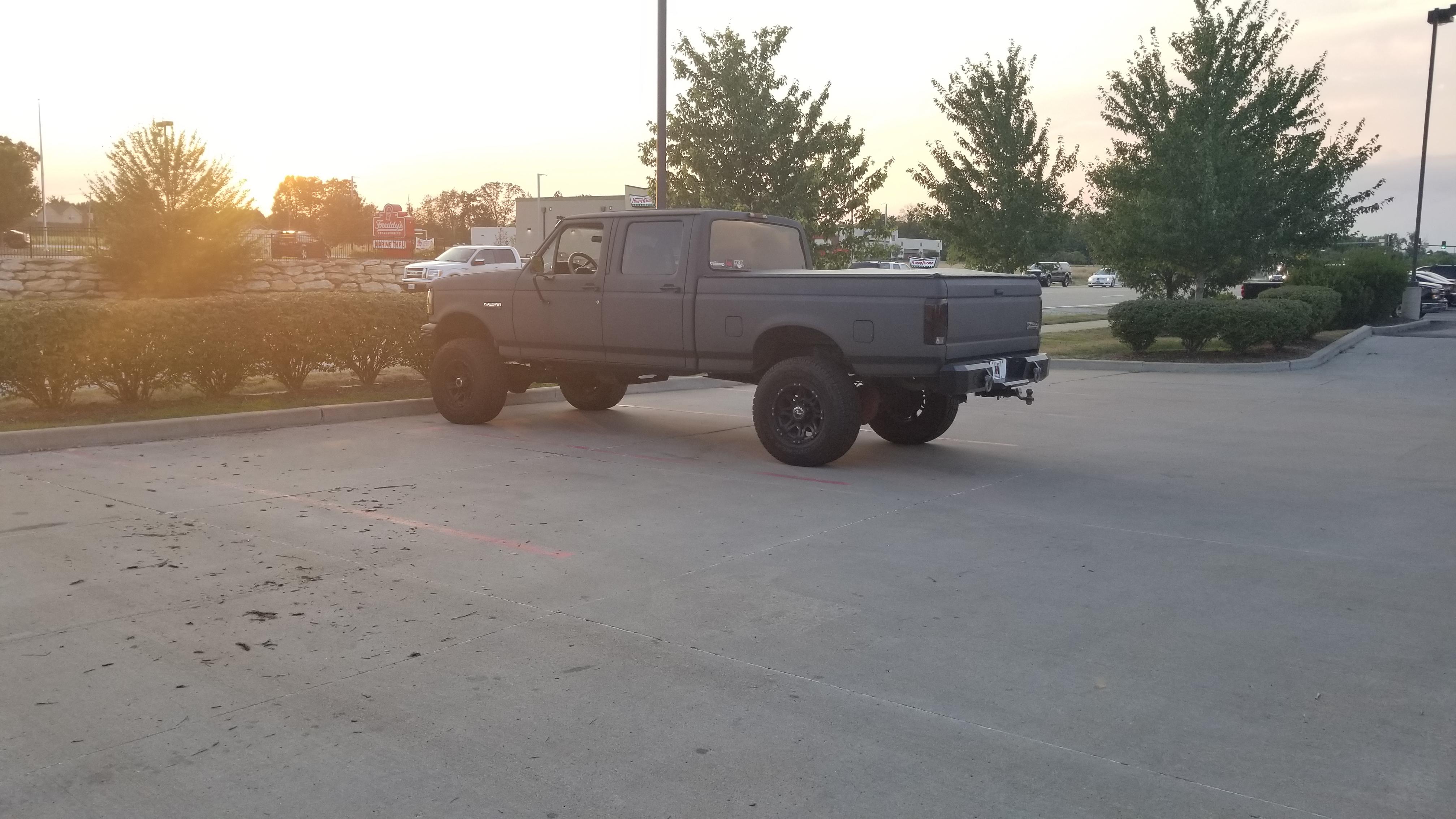

The truck is a 1997 f250 crew cab short bed powerstroke 4x4 auto. It's got a TS chip with generic tunes, NAPA 6637 intake, Diamond Eye 3" do and 4" straight pipe, 4" Rough Country lift kit, 315/70/17 Cooper at3's, 17" raceline raptors, everything is blacked out, its painted two tone with raptor liner, the top is Tunnel Ram Gray metallic, the bottom is satin black.
I'm parting out a car I bought and hopefully will be buying injectors, a kc38r, intercooler, cnc fab HPOP, traction bars, efuel, trans cooler, glow plugs, and a 3 pod setup. Then whatever money is left will build the transmission.
