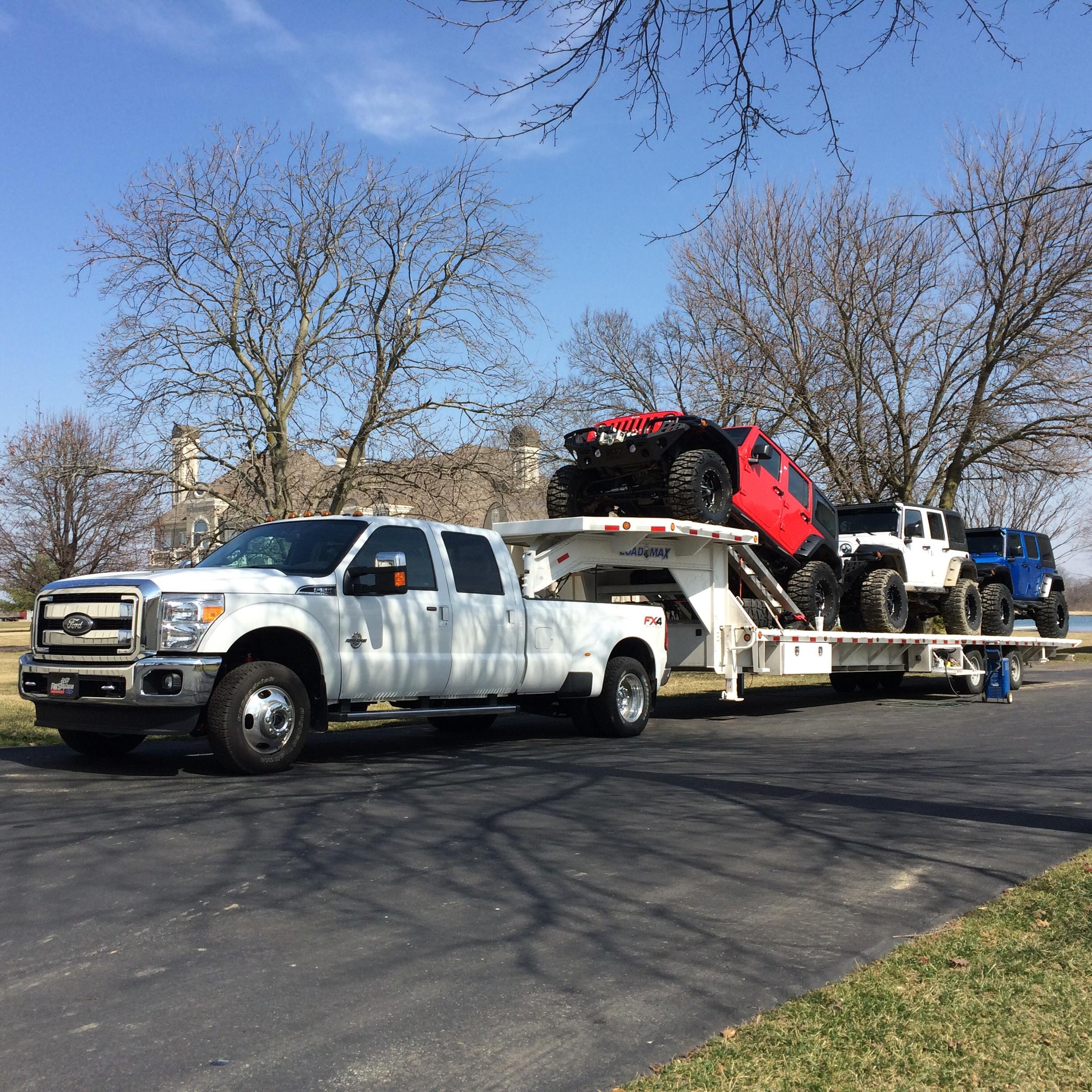

Well this truck is a deleted 2015 running pip tunes, around 40k gross here. No turbo barking that I have ever heard. Gears are 3.73. The truck loves it. Power is great even with all the weight. Maybe try different tunes?
