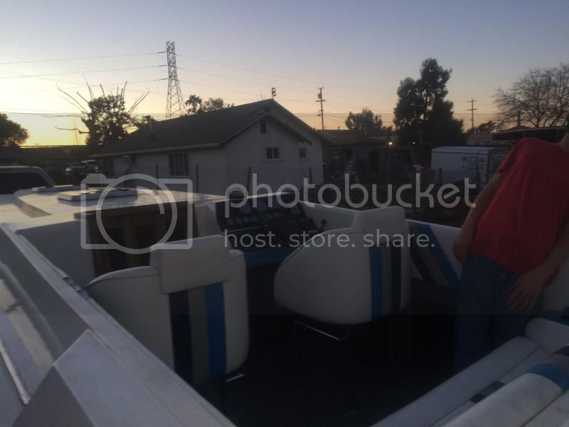

purchaced my dream vessle last week!
its a heavy lay 33' Predator off shore.
i purchased this beast with no engines, and no drives.
i am an avid boater, i have 3 v-drive flatbottoms with ford, chevy, and pontiac power.
I finally have something i can take on the open seas!
my plan of attack is to install 2 freshly built 97 7.3's
i have a core, but i need to purchase another, then i can have them machined to the same exact specs.
this is a long term project.
my hang up is the electrical.
all of the machining, i will do with the help of one of my good friends that owns a machine shop.
im currently looking for any type of shop manual that describes the wiring IN DEPTH!
heres a couple of shots that im working with.
no pics of the engine bay yet, i need to do some electrical to get the hatch open.
