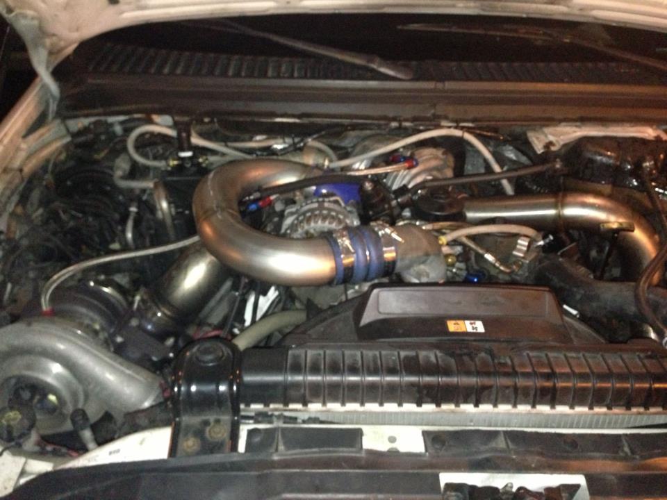

the injectors on MPD's vgt compound setup were 225/100's with the stock vgt turbo and a s472 like you mentioned with a 40mm jgs waste gate. I remember MPD saying that it towed awesome with low smoke and low egts.
strokin6L
2,979
Springville NY
Here's MPD's vgt compound setup.

the injectors on MPD's vgt compound setup were 225/100's with the stock vgt turbo and a s472 like you mentioned with a 40mm jgs waste gate. I remember MPD saying that it towed awesome with low low egts.
This sounds great , maybe with stage 1 vgt and a 472... 190's/100
