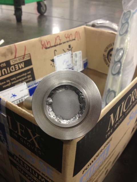

Weld up the ends of your existing cooler. Cheap and the same benefits as the delete ... View attachment 13387
Curious....did you pay to have that done? Welds? Or did you buy the cooler that way? Up pipe? And why pull the EGR and while in there just not delete it?
Again just curious. Everyone has their own opinions I guess.
To the OP get rid of it. Keep shopping around for installation prices, but have Steve help you out on an actual delete kit. Very simple to install and a great kit.
No I didn't pay. I had a buddy weld it and we installed it at our shop. It's tig, I know it's not pretty. Up pipe is still stock since the back of the cooler is welded up the same. Could I have done the up pipe instead , yes but I live in California and with our lovely emissions requirements and the resources I have available it's more beneficial for me to appear as factory as possible and not face any potential slack. Where I live they have mobile CHP smog stations they set up at random like a DUI checkpoint and they know exactly what to look for.

Right, welding it up may be what's best for inspection state trucks, and i get that, but it certainly is not the best solution when compared to a quality aftermarket EGR delete kit.
