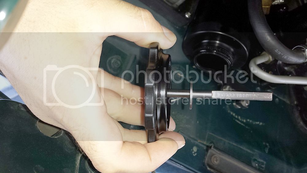

The engraved dipstick. I calculated the fluid expansion in Solidworks and it actually came out pretty accurate.

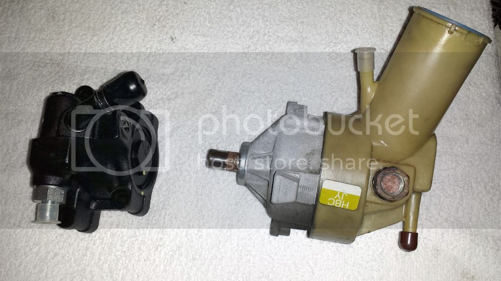

With that out of the way I moved on to the pump itself. I used a NOS 2005 6.0 pump that popped up on Ebay for less than most part store remans. It is marked HBD-MX and from what I could find published it puts out 2.8-3.2gpm with a min/max relief of 1750 and 1850psi.
The stock HBC-JX pump flows 1.4gpm with relief setting of 1400 and 1530psi. The HBC-JY which was used on the SD trucks with hydroboost flows 1.5gpm with a 1450 and 1530psi relief.
So the 6.0 pump put out a nice bump in both flow rate and pressure.

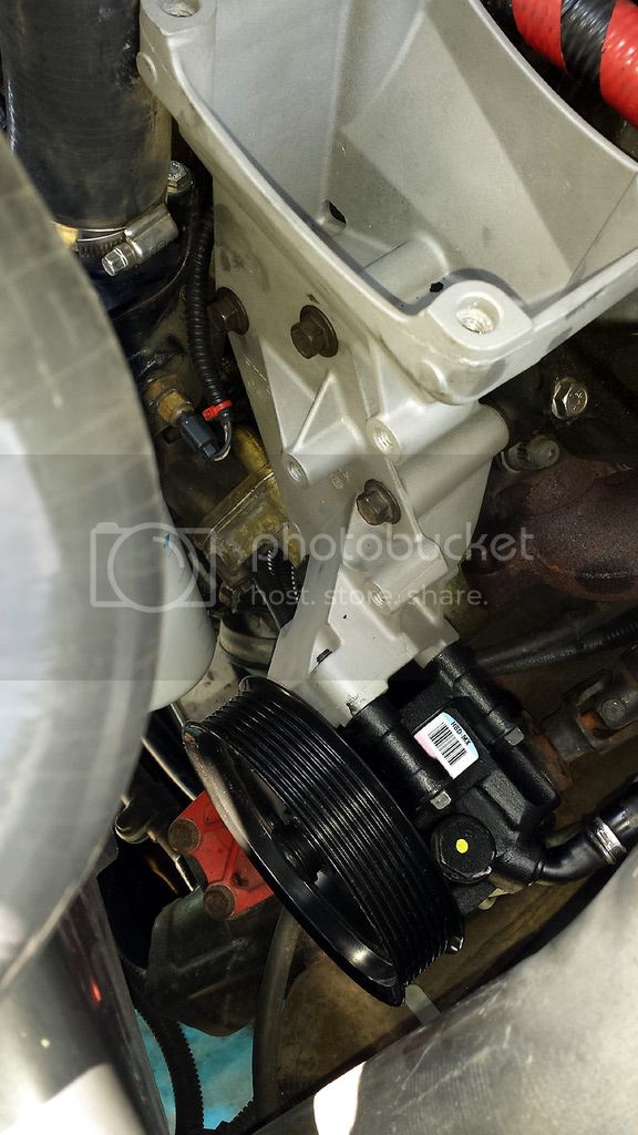

The pump bracket is from an Ebay auto salvage seller. New brackets are also available if you want to spend the money. This is a direct bolt in for the stock OBS part. Your AC compressor and vacuum pump will bolt right up. The orientation of the vacuum pump is now horizontal instead of being tilted up slightly but its actual position on the engine is the same. Same goes for the pump itself which means you do not need to get a longer/shorter belt.

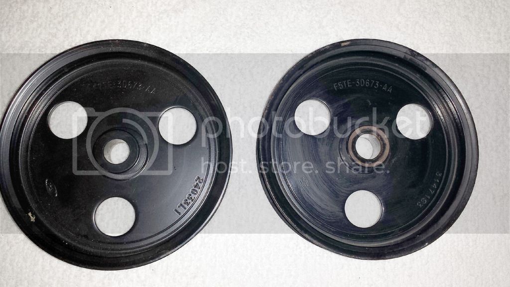

Now for the pulley, this might be the hardest part to get hold of. You need to use the van pulley, no way around this that I'm aware of. The C3 pump shaft is slightly smaller than the C2 so your stock pulley will not fit. The van one is identical to the stock pulley except for the smaller bore. Aftermarket pulleys are not available for the van so get scrounging in the salvage yards. Ebay again came to my rescue with a NOS pulley which is pictured on the left here.
Install is straight forward, just swap one bracket assembly for the other.

Billy the pulley is F7TE-3D673-AA and bracket F7TE-19E708-BA
