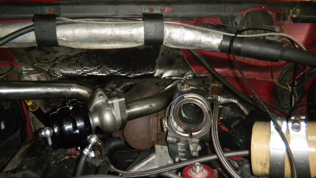

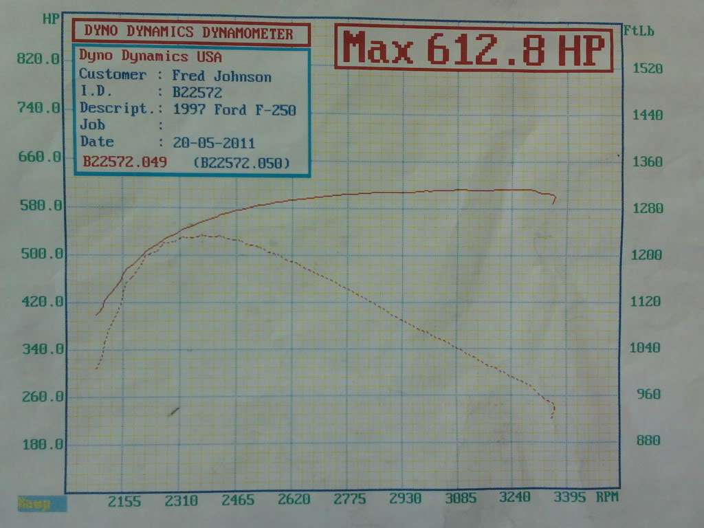

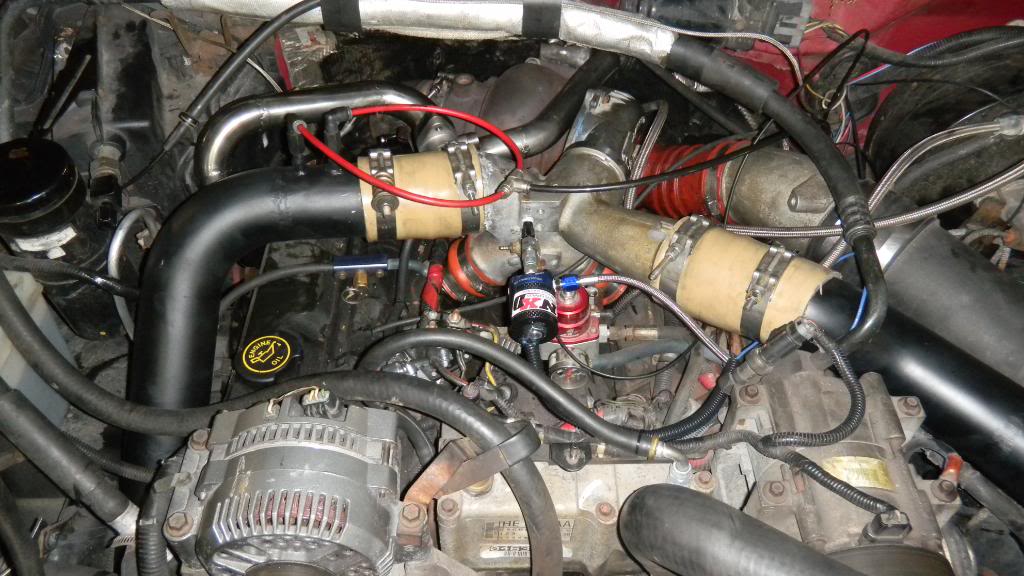

I would have to dig around for pics. basically was just a spacer plate with a tube welded on it and a gated bolted over pass valve cover. This was probably 5 years ago now. t4 mount kits are the way to go now. I will say a gated d66 with some spray is a super fun street truck, ran 12.68 @ 107 ish that was probably 3 or 4 years ago, Since I started the shop I haven't gotten out much lol. this is all with a set of 238s at the time and live tuned by no limit tuning. Thanks John and Cass.

Here are some pictures thanks to the wife.!! lol. I didn't even know I had these.!!
