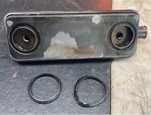

Does the international T444 use the same valve cover breather as the power stroke?
I’m stopping tomorrow at the local international dealer for some turbo O-rings.
Just wondering if they might have the breather O-rings also.
If so, anyone have a part number(s)

International is the same as Ford. These are the part numbers I have on file:
Crankcase Breather O-Rings
(Ford) F4TZ-6769-A (small; seals screw head)
(Ford) F4TZ-6769-C (large; seals breather adapter to valve cover)
(International) 1824452C2 (large; seals breather adapter to valve cover)
(International) 1820784C2 (small; seals screw head)
