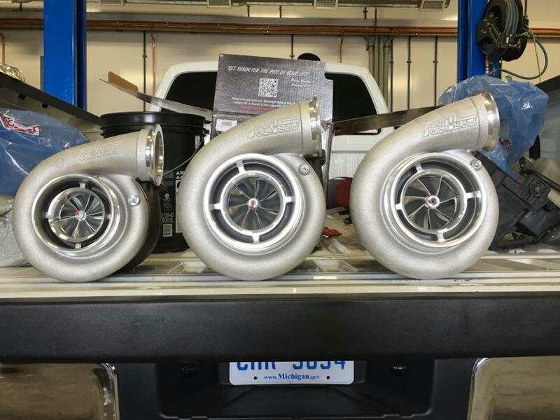

Well Morgan's new sales guy (Jared) talked me into one of these guys..
Precision Gen 2 8891

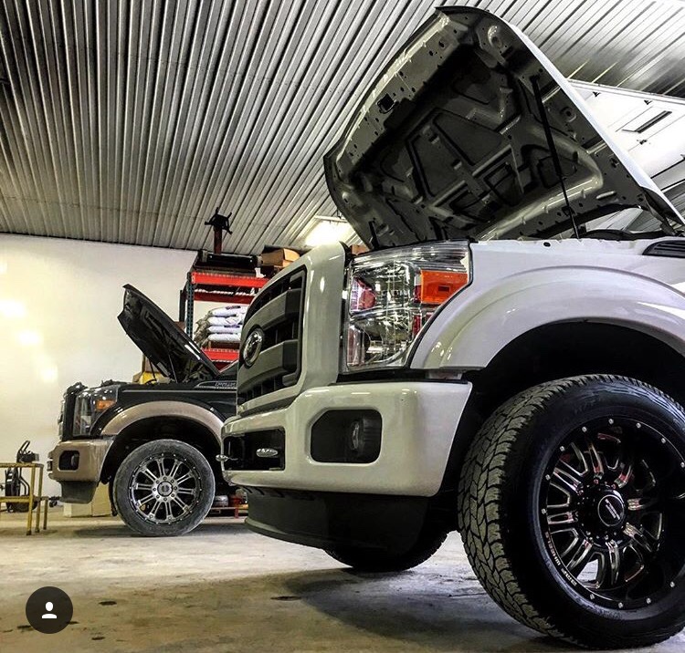

I drove the truck down a couple of weeks ago and after not even 6 months after leaving the shop it's back at Midwest Diesel & Auto gaining a turbo!

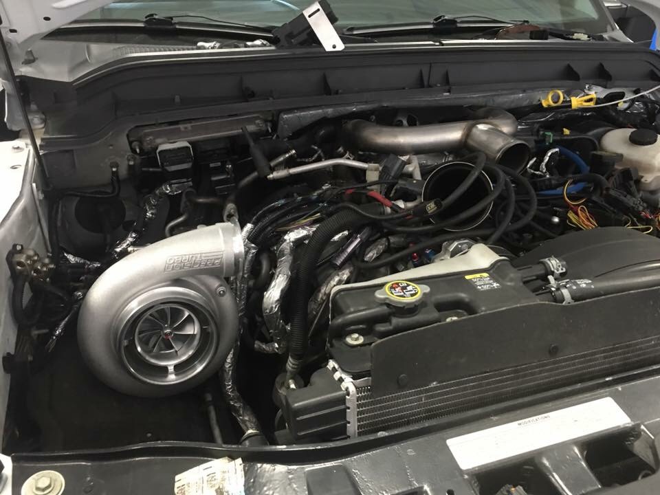

Oh yeah, it's also getting some ALA's, Track rod joint upgrade, and front truss with fox stabilizers courtesy of Jared and OUO
Six_Sloww
Dec 5, 2013
2,574
Southeast MI
It should have enough to split the block as it sits. I think the 100's can flow well over 1500 hp, if I run out of injection pump I can always go to a 12mm on the belt.
Only thing that that may happen on the fuel side is I may add another airdog so each pump is fed separately.. We shall see though.
