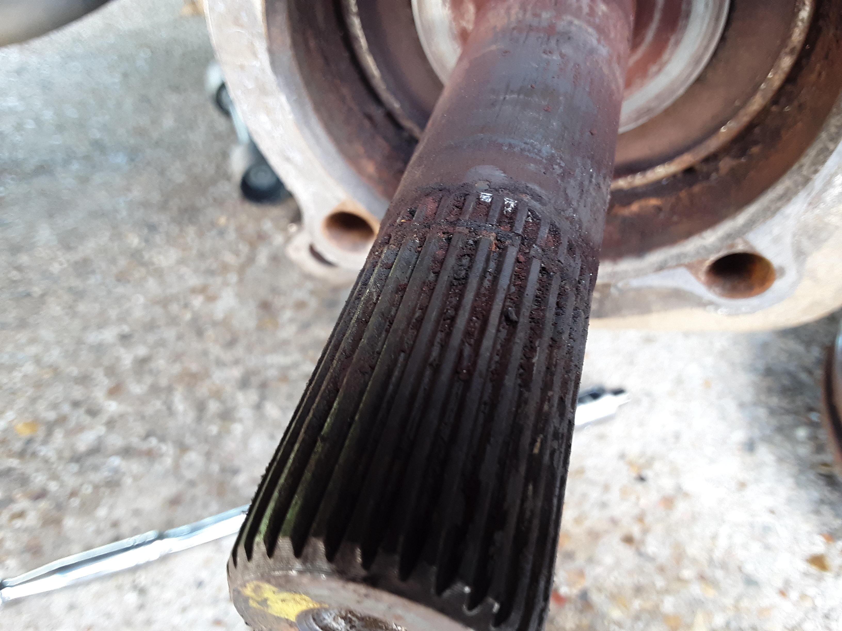

Still have to pull the axle
Turbosuzuki
May 1, 2012
403
Louisiana
Looks dry but not bad. How is the u joint.
Not sure haven't pulled the axle yet. Hopefully my problem is the bearing. With the hubs unlocked you couldn't drive past 30-35 without alot of vibration somewhere in the front end. Nothing feels loose and the tire would turn easy.
I have parts for both sides. New bearings stubby axle shafts and seals. New brakes rotors and pads so after I am done if it still does it not sure where to look.
Tomorrow I will pull the axle. This is new to me I have never changed a u joint either so watching videos on that tonight.
