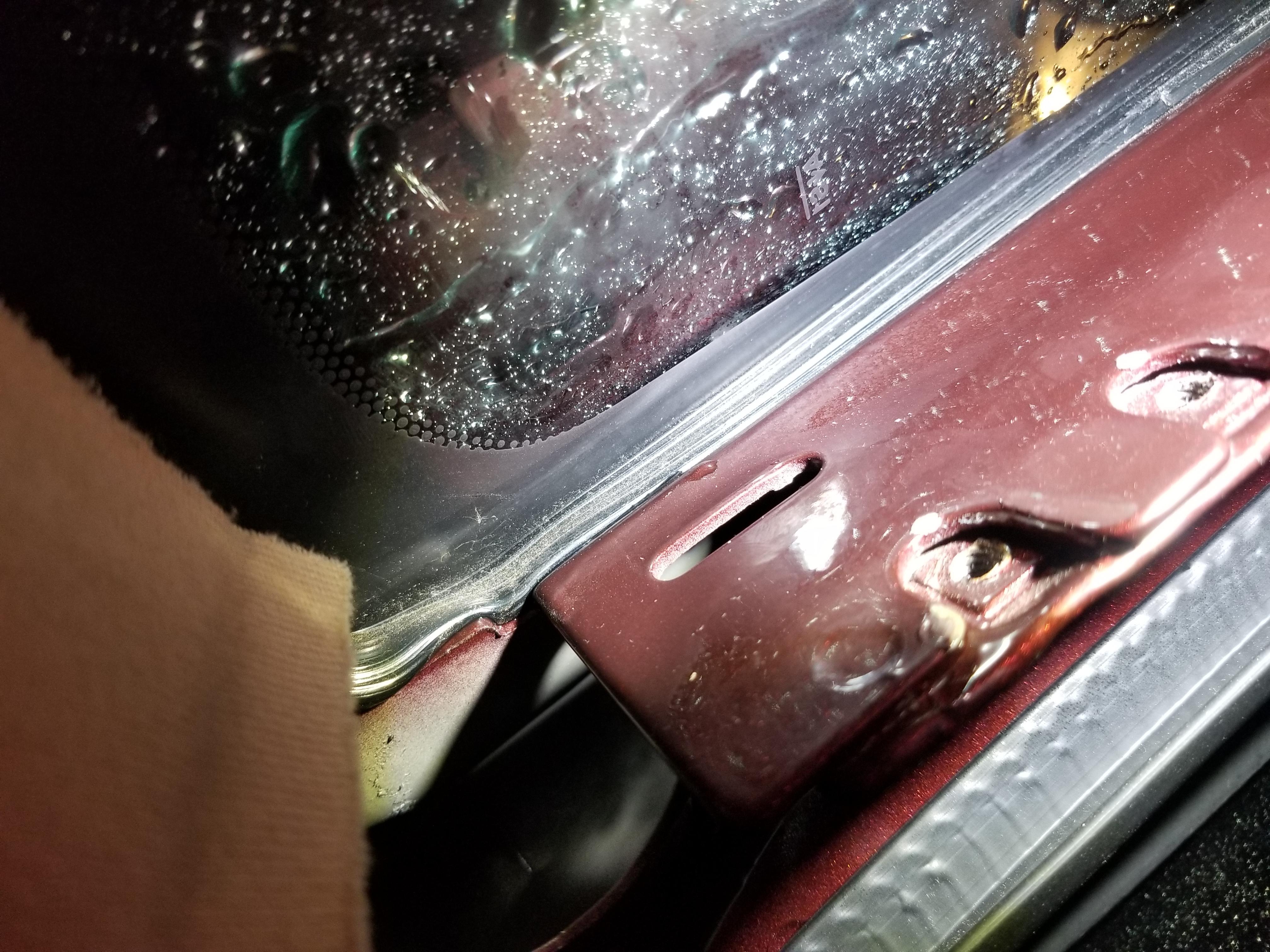

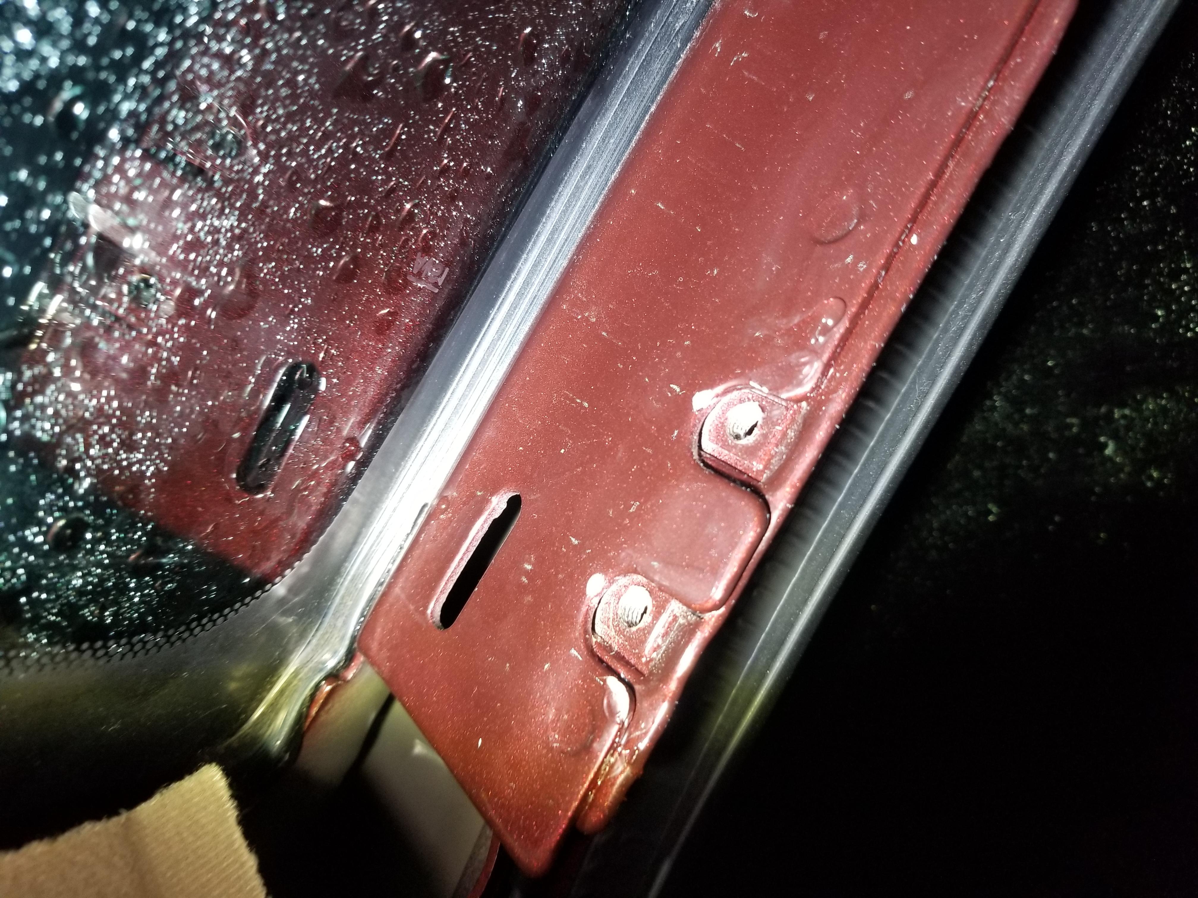

My 2010 F-250 also has the A-pillar leak on the drivers side. Usually is the worst when its been sitting during heavy rain. I have no cab lights on this truck. So the three possible spots I narrowed it down to were the SiriusXM antenna, the moon roof or the windshield. So I took apart the A-pillar trim and lowered a section of the headliner. No rust on the sirius antenna hardware, moonroof hoses still all intact and no evidence of water running on top of the headliner from what I could see. Had a friend soak the outside while I was inside and couldnt even get it to leak. So frustrating. Thankfully a couple nights later really heavy rain cane and I hopped in the truck. Then I noticed water finally! Traced it as high as possible and mine appears to be coming from the upper corner of the windshield. With it bubbling in slowly I reasoned it wasnt an issue any higher because everything above was completely dry still. Still need to get my new windshield installed to call this item 100% done. But hope this helps.
