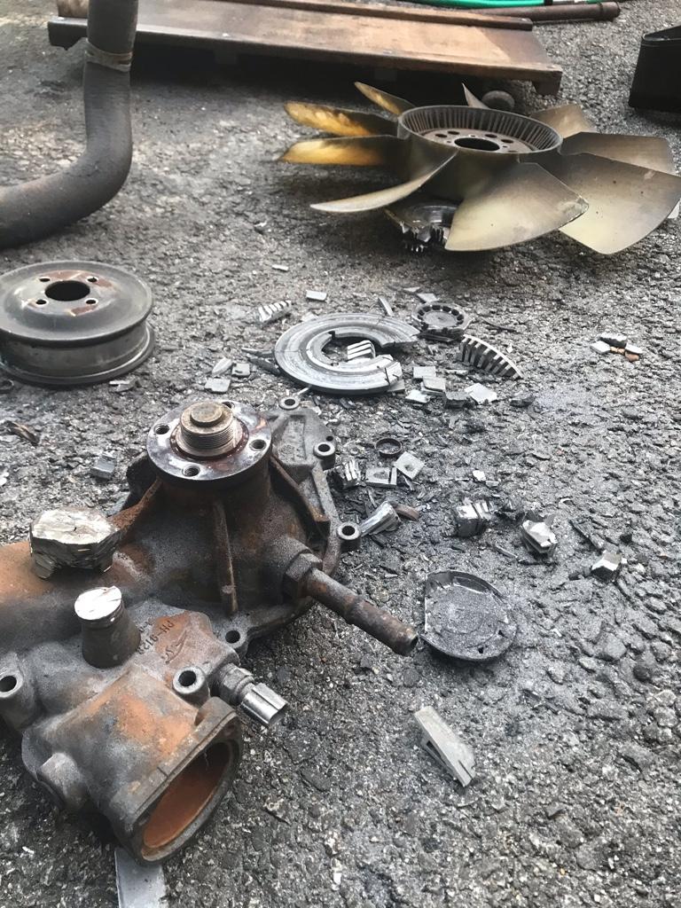

What i had to do to get the fan and pulley off of the old one

Good lord.
I can hear the cuss words coming through your picture.
Good thing I was not drinking coffee when I read that. I laughed out loud.
Air hammer is in the barn with the big compressor.... And my big vice is in the storage container with the disassembled workbench.
I quit once I got to that point last night. After work today I get to pressure wash the front of the engine, Lots of oil and sludge on there, and hopefully find that pesky oil leak.
I had to pull the battery, air intake, battery/intake box, power steering pump/bracket to get the fan/water pump assembly out. That was when I was cussing. Destroying the clutch and shaft with the grinder/cutoff tool was not bad.
