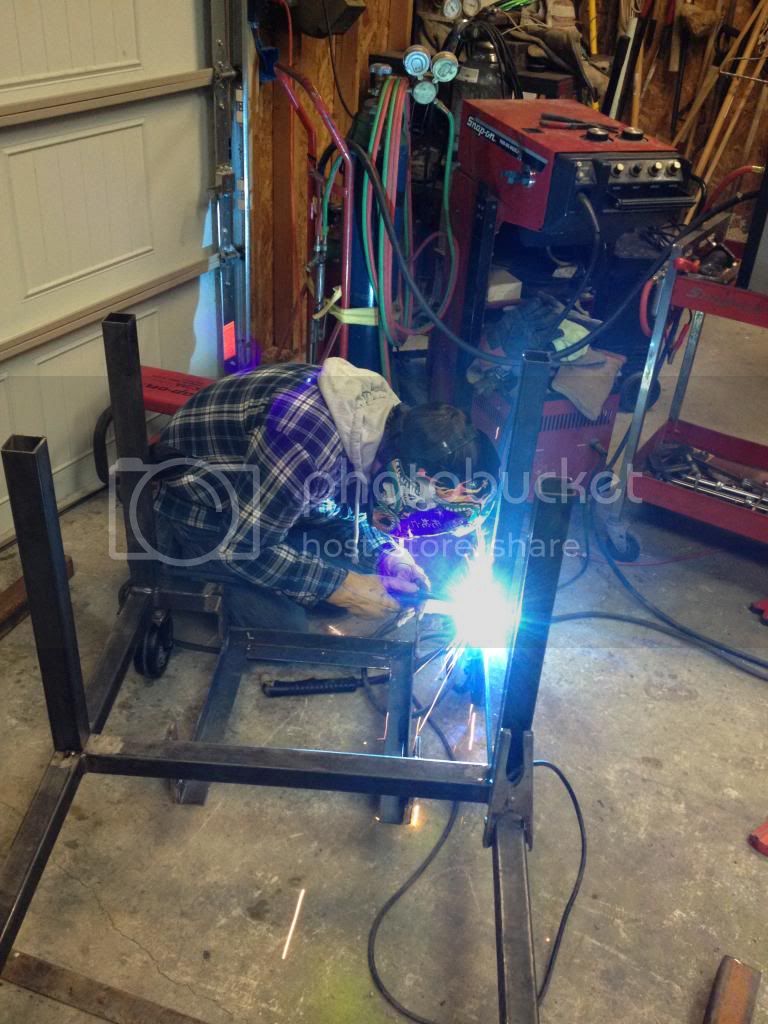

build photos are being uploaded to photobucket as we speak. I blame any unnatractive weld on my 35 year old welder lol! The welder actually caught on fire halfway through the build. The top plate alone was 407 pounds, and i cut about 8 inches off of 2 sides so it probably weighs in around 300 pounds still. Overall if I had to guess id say it weighed somewhere between 700-900 pounds.
emanmx11
Jun 29, 2013
84
Mico tx

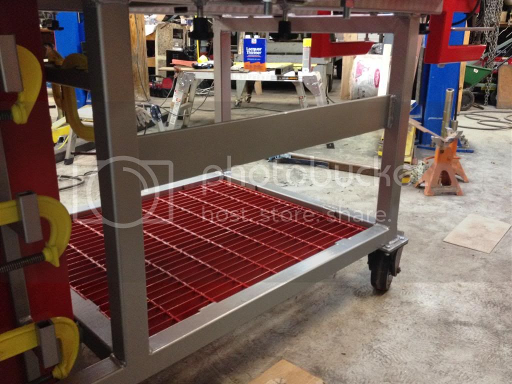

The Base is made of 1/8 2in square tubing. As you can see i had to drop the toolbox frame below the base, to keep the tabletop height low enough and workable. I used 3/8 steel to drop it a total of 5 inches. The angle iron is 2 inch.
Base is complete, and i test fitted the tool box to ensure my measurements were correct. I cut plates out of 3/8 plate and welded them on all 4 corners to screw the casters into.
Next are the legs of the table and the top rails.

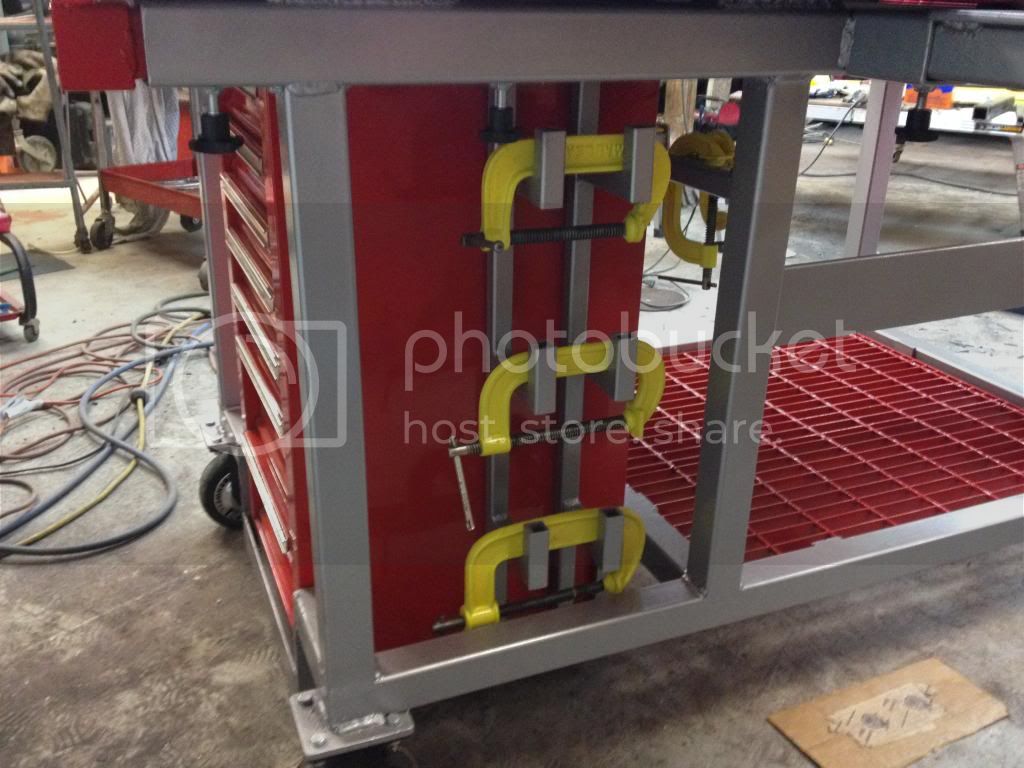

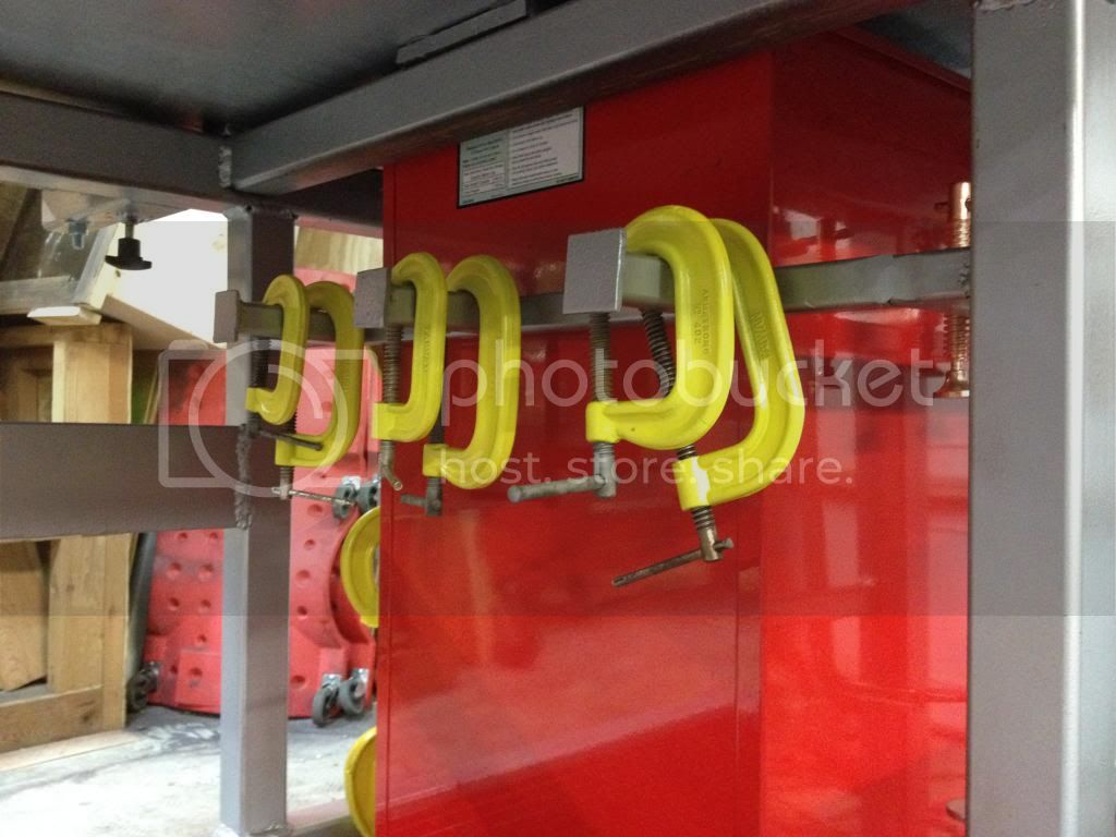

Next was the side mount for clamps.
The clamp rack is made entirely of 1in square tubing. As you can see i also welded in a different style clamp rack on the side across from the other. It is also made of 1in square tubing.

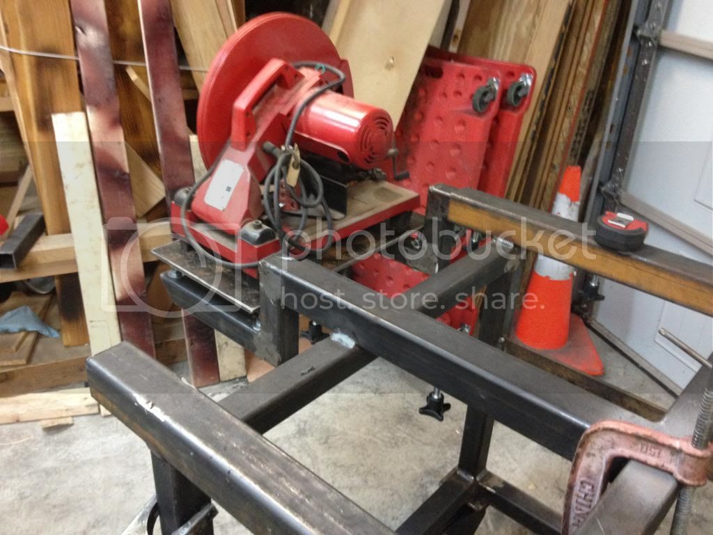

Next was the slide out mount for the chop saw.
The slide out chop saw mount is made of 1/8in 2in square tubing. The plate that the chop saw sits on is 3/8 steel. I lowered the chop saw mount itself to be flush with the table to make cutting long material easier.

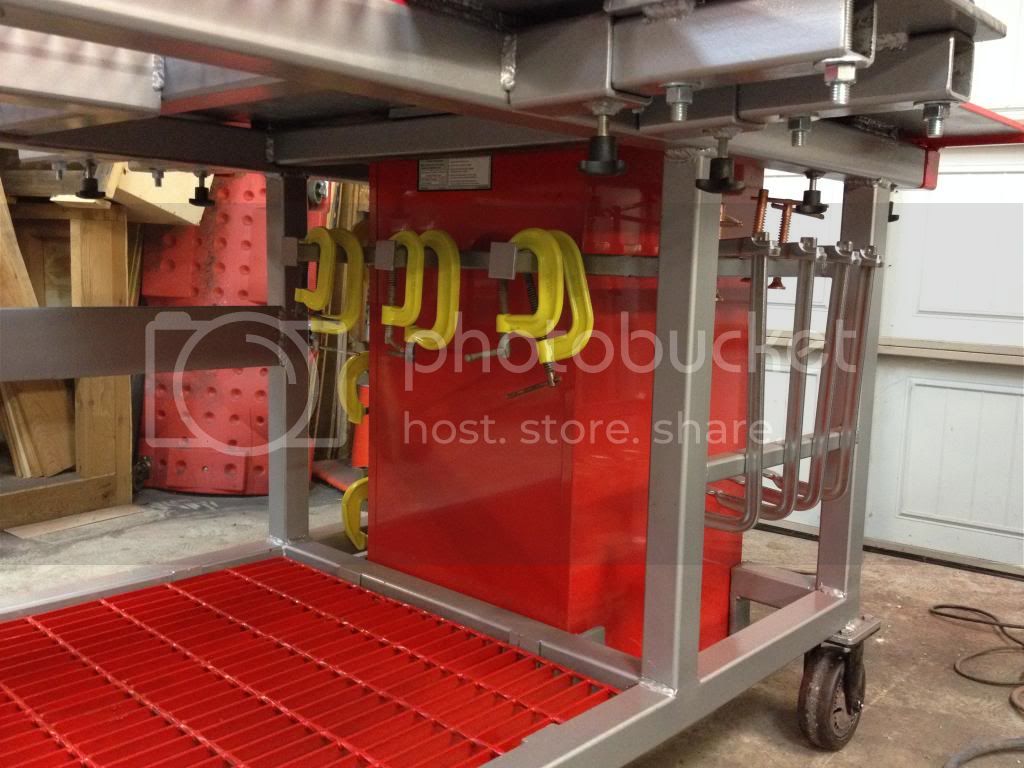

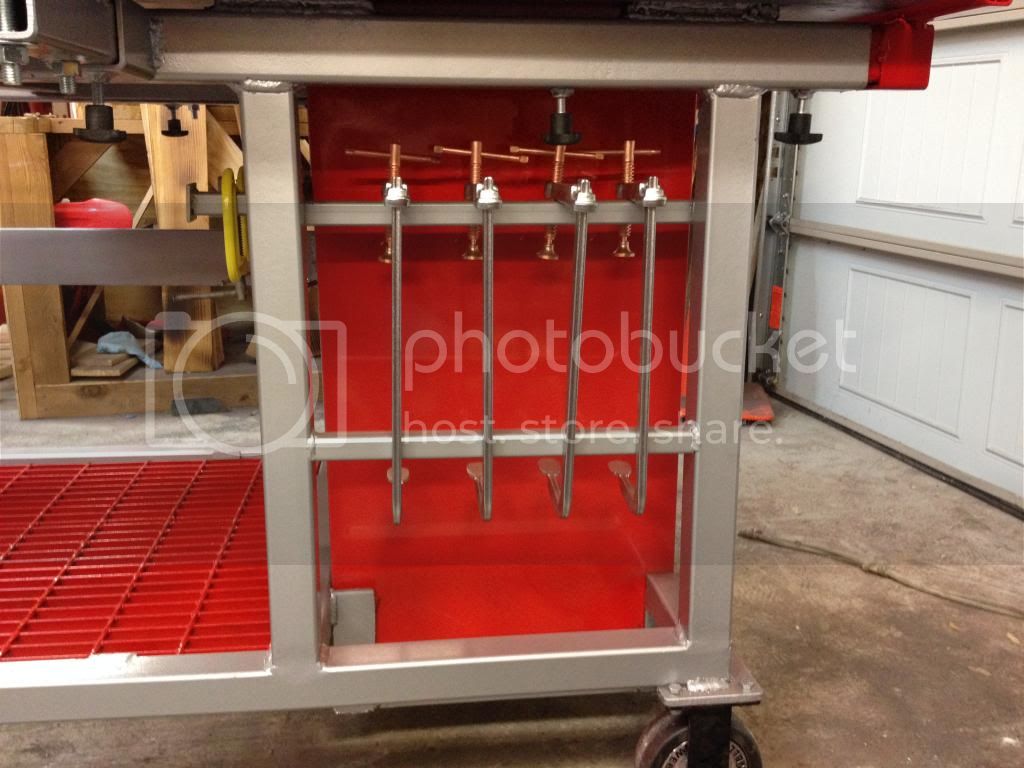

Next is another clamp mount underneath the top rails.
This mount is very simple, designed for smaller clamps. it is made of 1in square tubing as well, and I welded small plates on the end of each one to keep the clamps from sliding off.

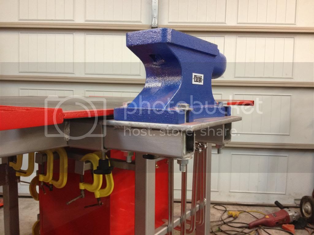

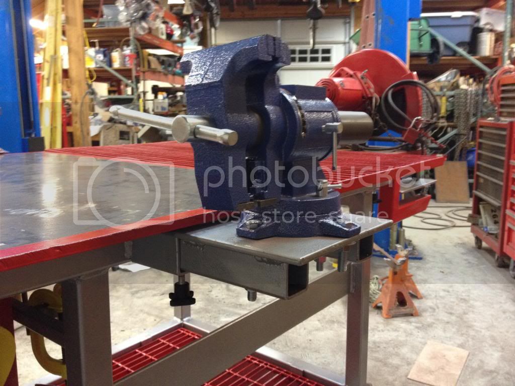

Next is the side mounts for the vise slide out, and Anvle slide out.
The pictures for these aren't that great, but the are 4in long pieces of 2.5in 3/16 square tubing. I drilled holes in the bottom of these and welded nuts for screw in handles as well, to hold them steady while in use. Both the anvle and vise slide outs are interchangable on either side of the table. The plates that they are mounted on are 3/8 steel as well.

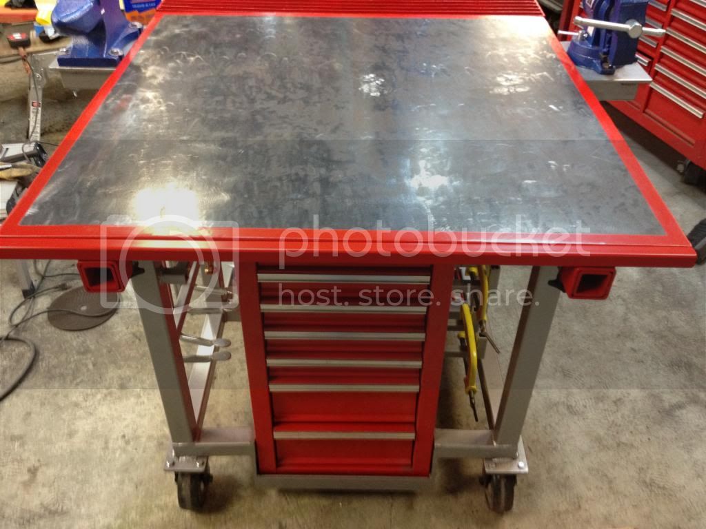

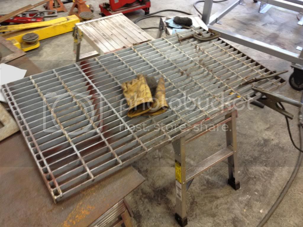

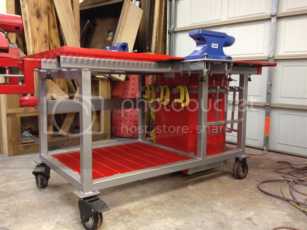

Ontop of the table, a portion of it is a thick grate which will be used to plasma cut on.
Since the grate is 1 inch thick, and the top plate is 1/2 inch thick, I welded half inch thick spacers all around the table where the top plate will sit in order to make the grate level with the table top. This way, sliding material across the table when cutting would be a breeze.

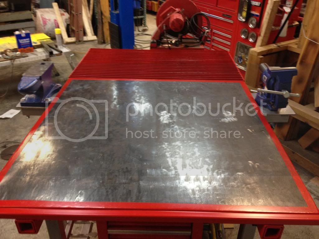

After some touch up paint and re installing the tool box, the top plate and grate were ready to be installed.

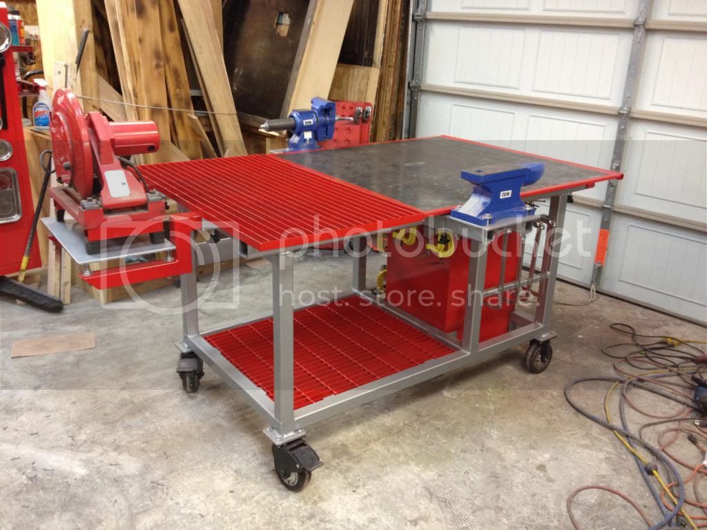

The finished product! I dont have any build pictures of the slide out on the other side of the table to help support long material when cutting, but i can give the details on it.
It is designed to slide out 40 inches, and still have plenty of support. It is made of 2in 3/16 square tubing. I painted the first 13 inches on each arm a bright orange, so that i know where to stop when pulling it out for use. I cant wait to start using this table!
