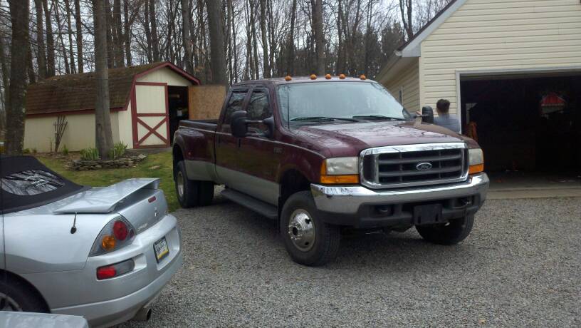

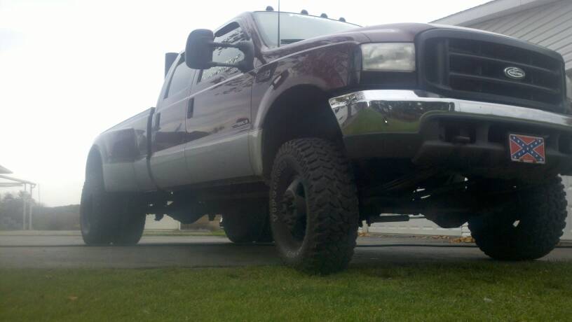

I thinks she finally let go. My truck has been giving me more and more problems lately. Now i have been beating on it pretty hard and she hasnt missed a beat until now. 2000 f350 cclb drw 7.3 auto. Ts 6pos air raid intake and straight 5 inch exhaust to dual 6inch stacks. Leveling kit on 315 75 16 firestone destination mts.
It was beat when i got it but now i have fuel comming out the leak in my oil pan. It wont even start. I lost my acell pedal last week. Rolls over really fast like i lost compression. Havent scanned it yet. Mabye i will tonight or tomorrow night. Any help on this would be awsome. Im thinking the motors gonna have to come out though.
I guess i didnt really want to drive it this winter anyways. But it wont fit in my shop anymore so i have no clue where its going to happen.
Stay tuned for updates. As ill be diaging it soon to try to get it goin asap.

sounds like you beat a beautiful truck until something finally happened.

For what it's worth, that was a nice looking truck though.
