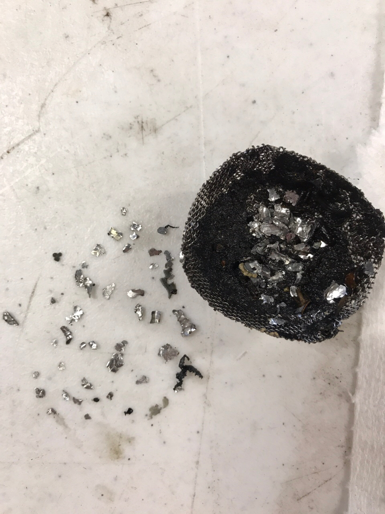

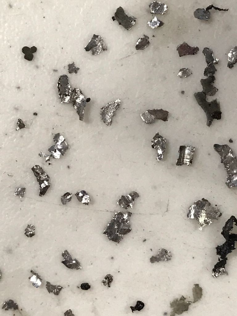

So let's place bets on what is happening. Looks like motor is eating itself. Went to replace lower pan gasket to day only to uncover issues.

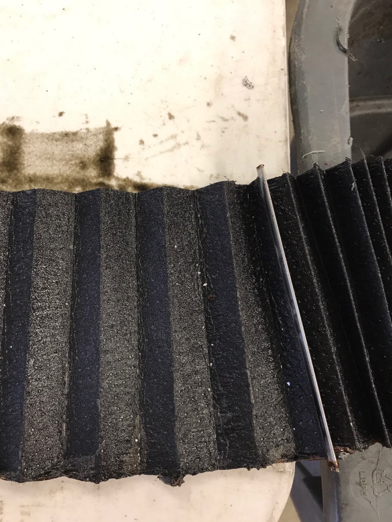

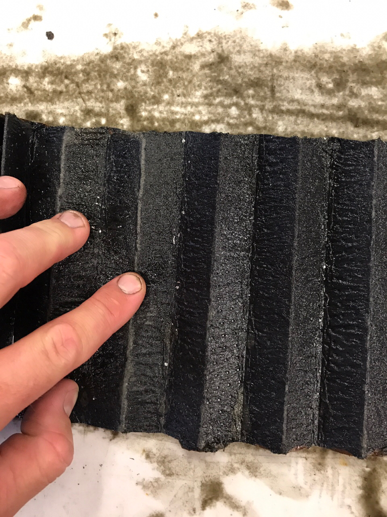

These last two pics have some crap in them that was already in the strainer on our oil drain cart.

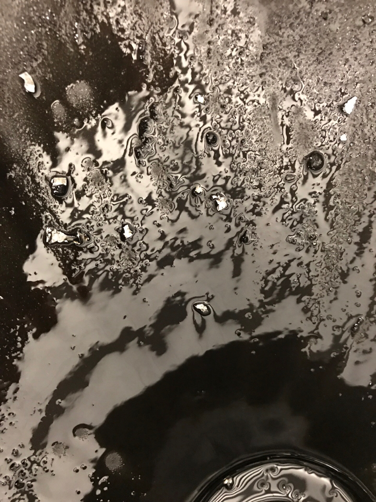

So in the pan I found a pure pieces of black rubbery material. Not too large, then we found what looks like a part of a valve stem seal. But since I did not notice anything until I dumped the pan and looked at the pick up I am unsure if that rubber piece was in the pan.
Everything for the most part is super thin which makes me think bearing but nothing was discolored and no unusual noise.

Yup. I'd be quoting a new motor if that came through the shop. I just did one with much less in the pan but about 3x as much in the filter.

Had one of my good fleet customers have the same scenario. Doing a lower oil pan, found the same chit. Cant see anything with the design of the upper pan. He decided to keep an eye on it, and do oil analysis to keep an eye on if it was getting worse. He made it about 2 months/15k, before it finally chit. It was popping thru the intake, huge clouds coming out of the oil fill and intake, and knocking pretty bad. Didnt tear it down to see what happened, but ended up putting a drop in motor in.

It's going to be a cam/lifter failure.

Even if it was happening when Cody had it he would have never known because nothing came out when draining the oil. It was all in the pan.
