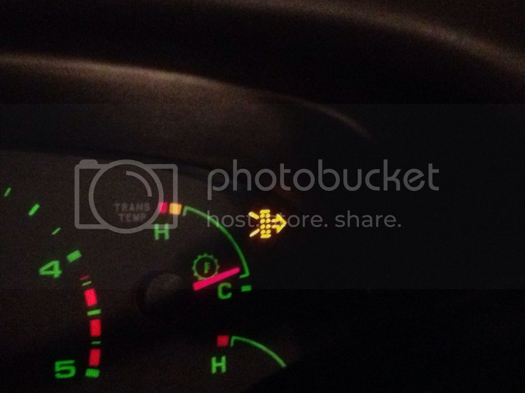

Just came on today out the blue. Is it a filter or something? I've got an AFE and it's pretty clean so not sure why it'd be coming on if that's what it is.

Just remove the filter minder. I had mine come apart on my 04. I found all the pieced under the hood and put it back together with superglue and never had that issue again

We had one of ours come apart too. When i glued it back together, i glued the plunger down so it always thinks the air filter is good. We check the filter during each oil change so it's not really needed. Light hasn't came on for about 7 years. :D
