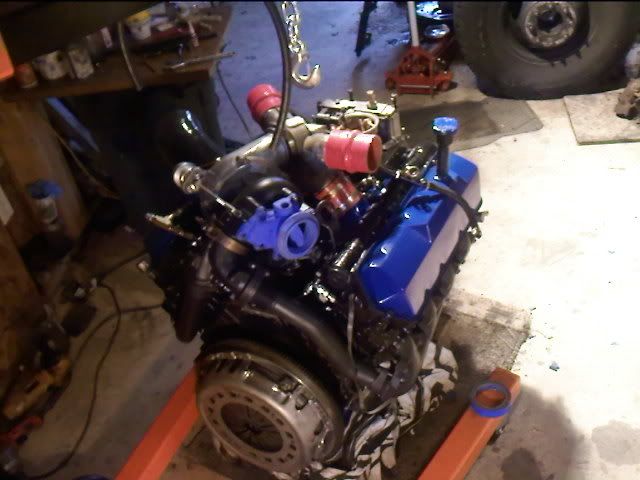

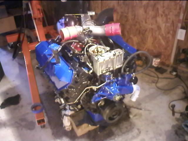

Im swaping injectors from my truck, to the engine on the stand. I should be running a compression test friday if everything goes good. I was wondering what are good numbers for the compression.

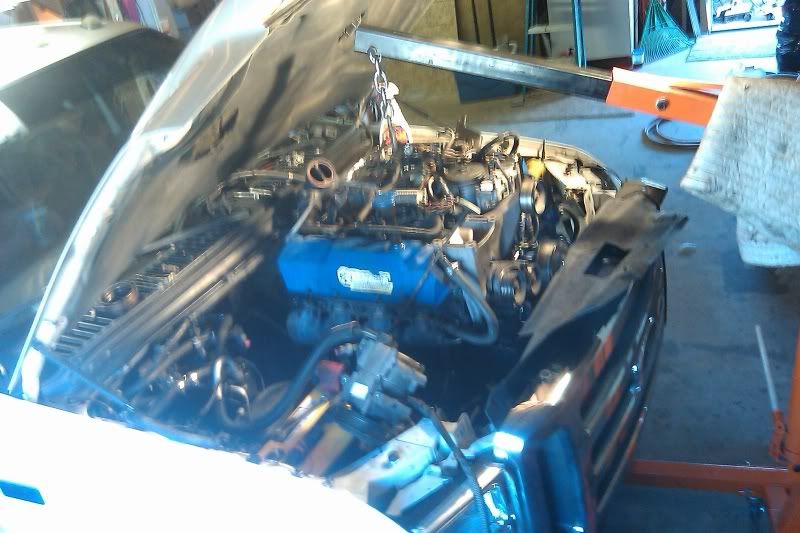

I am going to teardown the 97 first and see what it looks like before I tear the 01 one out I still want to drive the truck. Might have to try some cryo forged rod in this engine and other stuff.
