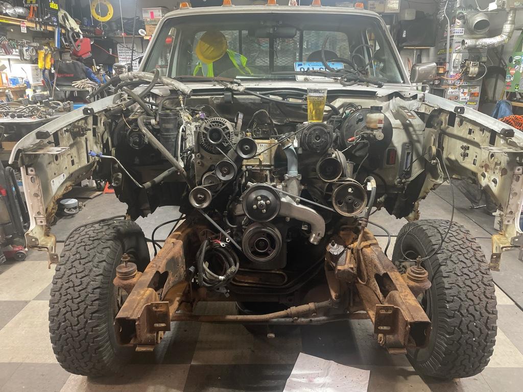

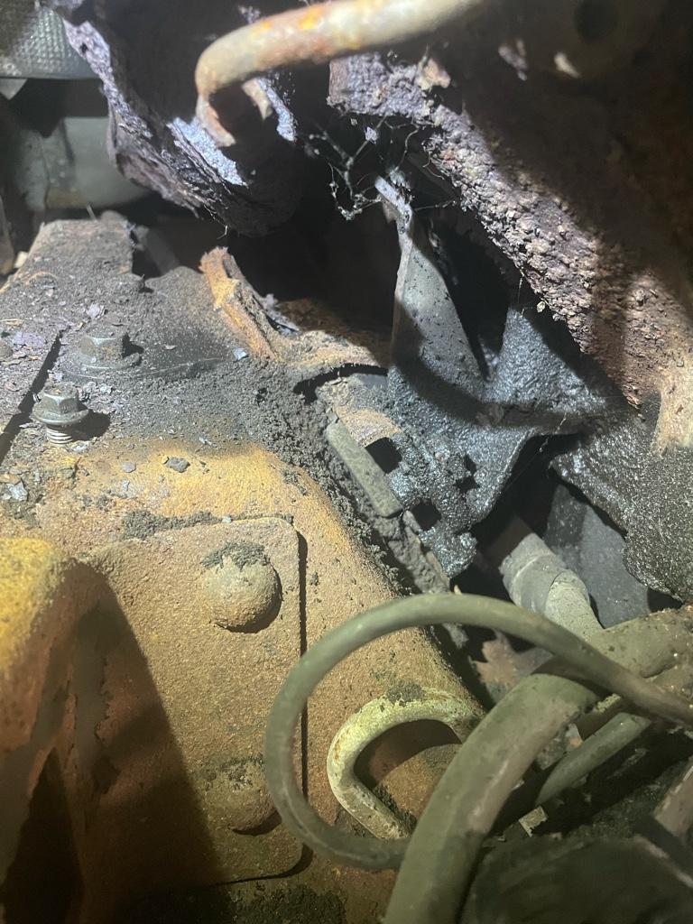

Should I unbolt to remove the engine ? Getting ready to yank. Any help appreciated.
Oct 23, 2021 #1 JohnT24 Active member Joined May 23, 2013 Messages 868 Reaction score 34 Location OXFORD CT. Should I unbolt to remove the engine ? Getting ready to yank. Any help appreciated.
Oct 24, 2021 #2 Petro Well-known member Joined May 22, 2011 Messages 1,209 Reaction score 33 Location Lincoln Nebraska Take the nuts off under the cross member or engine cradle. Will be two on each side. 21mm's I believe. When you lift the engine the studs will come up and out.
Oct 24, 2021 #3 JohnT24 Active member Joined May 23, 2013 Messages 868 Reaction score 34 Location OXFORD CT. Thanks
