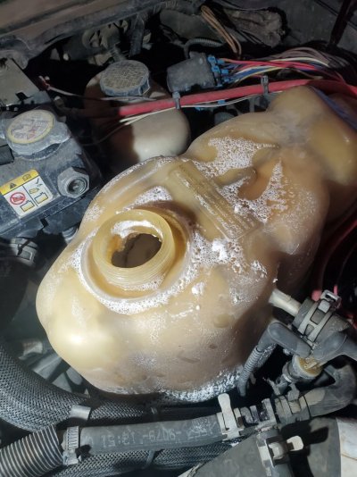

Here's a weird one for you guys. Customer called me this morning and told me his 6.4 has a foam like substance coming from his degas bottle. I automatically assumed oil cooler but now that he dropped it off, I'm not sure. Now keep in mind, I haven't even began to diagnose this, and a couple of other shops that I talked to said it was new to them also. Foam has about the consistency of whip cream, smells like coolant, tastes like coolant and is a white or off white color. Truck is deleted but EGR coolers are present. Truck is not low on oil and oil looks fantastic. I was thinking a possible EGR cooler ruptured and is some how aerating the coolant? Not sure. Truck also runs flawless. Didn't get hot, no issues other than pushing out foam 😂. Anyone else seen this issue?

Could be a dozen things, who knows whose pouring what....
. Remove the bottle, before draining the radiator to avoid that stuff washing down into the system.
Pull yer block drains and assess... Go from there.

Could be someone flushed it with something and didn’t get everything out. Basically ^whs

I should mention, I know the guy that owns it very well. I've been working on their stuff for close to 10 years, it's all meticulously maintained and I know he wasn't adding to the coolant system and it hasn't been flushed recently or coolant hasn't been added.
