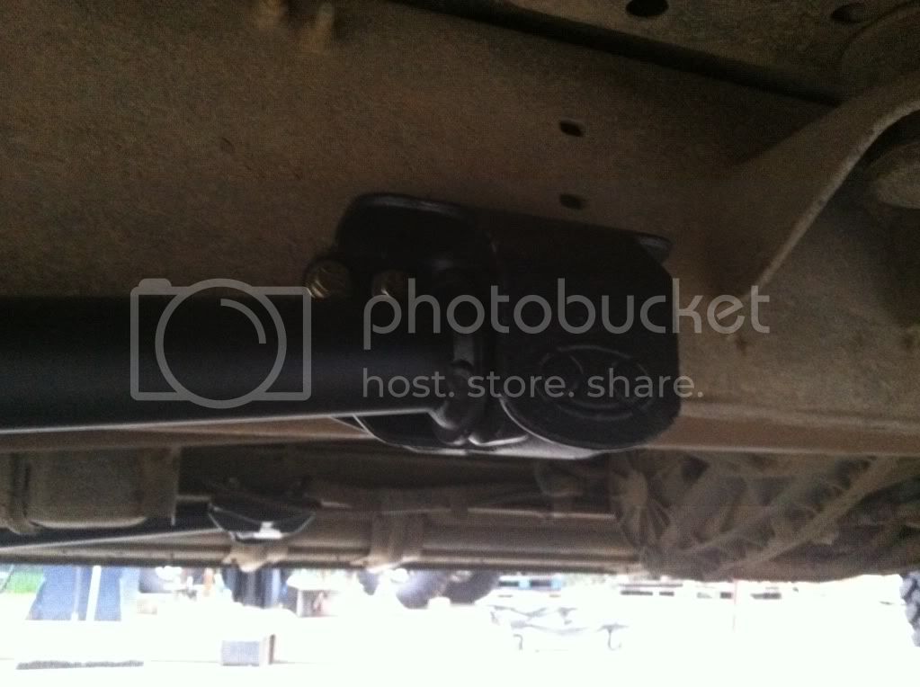

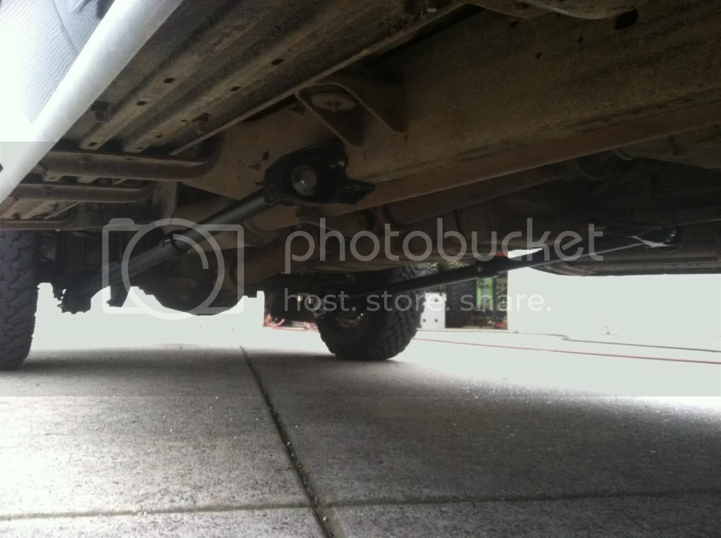

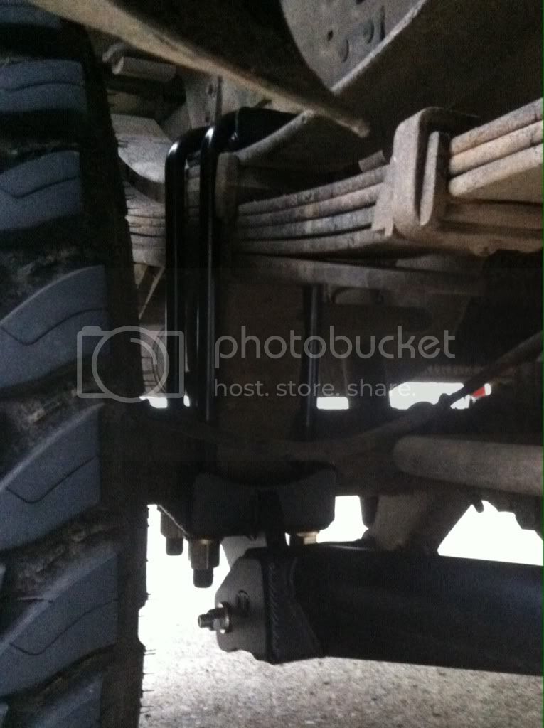

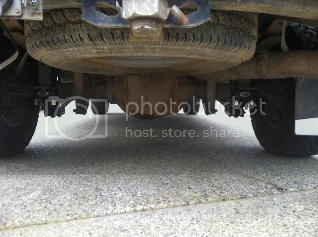

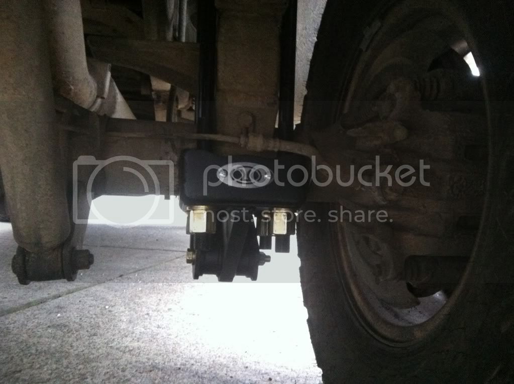

I think the OUOs ran $600 or so for the set and around $250-$300 or so to have installed at my local shop. I have the weld on version.

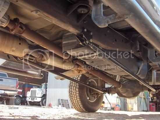

I built my bars, got the frame mounts from a member on here and axle mounts from a friend with a CNC machine. Bars are built out of 2x.250" DOM with tractor 3rd links. Been on for 2 years with a ton of abuse and heavy towing with 0 issues. I think i have around $150 in em plus a couple hours of fabbing/welding/drilling/painting.

You got any pics of them. I want full length ones.
No but they look similar to these
