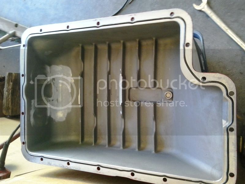

Here is a pic of the inside of my Mag Hytec 5R110 pan that I modified to run the 5R110W filter.
The filter only sits about 1/2 to 3/4 of an inch off the bottom.

I know they do and the filter is only about 3/4 of an inch off the bottom. How much lower do you want it?

There is no adapter that is just where the filter is. Even before I cut the stands down to fit the deeper 5r110w filter the filter was only about 1.25" off the bottom.
