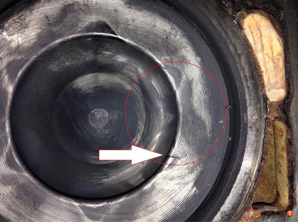

So I have my motor apart for head gaskets. I sent the heads out to get checked and the machine shop had to replace 5 valves (1 intake and 4 exhaust). I was curious as to why the valves were bad so I took a closer look at the bottom end. I noticed this:
The circle shows where the exhaust valve hit the piston and the arrow shows a crack that starts at the edge of the valve damage.
I'm really wondering what happened here. I do have a mini maxx on the truck but I've never turned it up all the way and I don't beat on the truck. I've also never manually shifted the truck so it has never revved beyond what the computer will let it. Are the stock valve springs that weak? Motor has 107k on it.
As of right now I'm planning to replace just the one piston with a factory stocker and button it back up. All other pistons look fine and the cylinders look beautiful. I don't have the money to upgrade pistons so it is what it is.

Excessive back pressure or maybe an over rev.
you might want to check piston protrusion before you botton it up
What they said, also has the motor ever been into before? I have seen several sets of heads below min spec, even remans. We don't have much forgiveness on these engines so measure protrusion and heads make sure it's in spec.

I honestly don't know if it has been opened up before, but it doesn't appear to have been. I bought it used with 77k on it and I have no idea what the history was in it. I do know that it was bone stock when I got it and didn't appear to ever have been modded. I have never overevved it in the 30k miles that I have put on it.
What would cause excessive piston protrusion?
I will measure the heads since I know the machine shop milled cut them for flatness.

Excess back pressure may be a clue since I have gotten a code for high back pressure while towing with the mini maxx set on mild.

That's odd. I ran the canned tunes for over a year and never had excessive EBP except on the hottest tunes....of course, I do have a few mods. Any chance the VGT is acting up?

I'm gunna say high ebp, there are several reason as to what caused it, a sensor starting to go bad can give funky numbers and make your back pressure spike dangerously high, also vanes could have been sticking too

Each time it has done it I was towing up some steep grades with about 10,000lbs behind me. Mini maxx set on mild. Motor wasn't working real hard, mid rpm. When it throws the code it goes into limp and I have to pull over and reset it. It has happen 4-5 times in the 2years I've had it.
