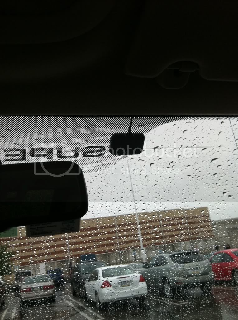

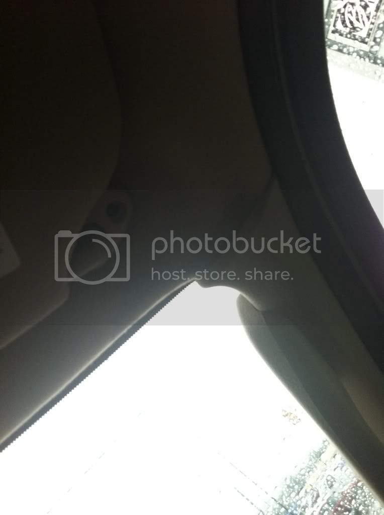

so, bought the 08 in august and there really hadnt been much rain since then.. last week it was raining pretty hard. my dad was in the passenger seat and was trying to figure out why he was getting wet. Theres a leak around the windshield somewhere or one of the cab lights. water was dripping from the screw that holds the sun visor to the roof, and the headliner was saturated where it meets the a pillar plastic.
in that picture you can see where it was wet and the screw it was dripping out of. any ideas of what could be causing this? I think it could be a badly sealed cablight because as far as i can tell the windshield is original...
the truck does have a sunroof, and i checked to make sure it was closed, but i dont think the sunroof would cause a leak there?
another thought is was this in the next picture looks aftermarket.
because theres a sirius antenna on the roof and so, if this was installed maybe something happened when they pulled the headliner back? not really sure.

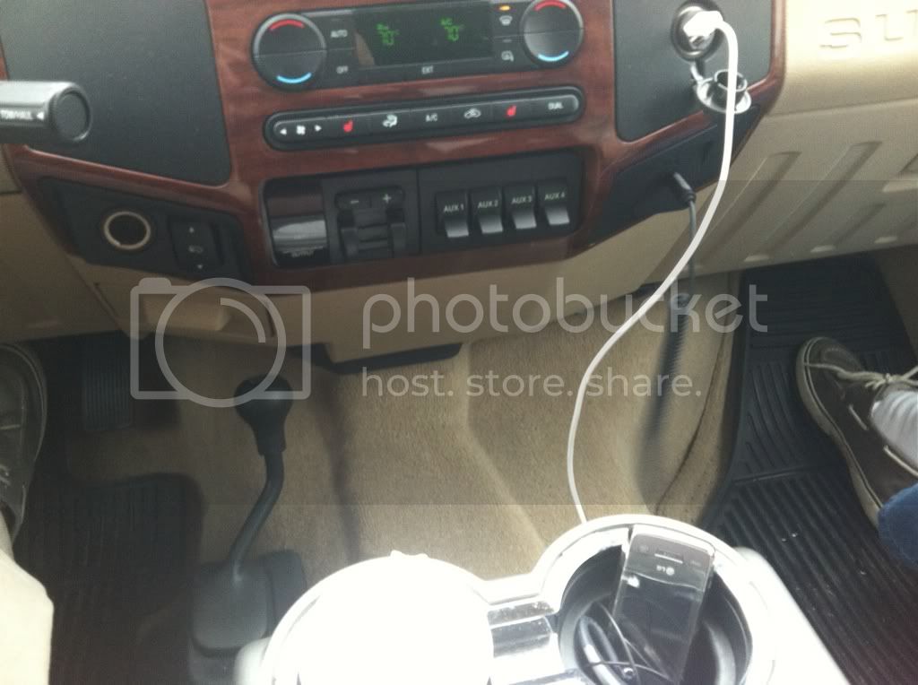

and then just a general question. I drove a early 08 with the electronic shift on the fly 4x4 and it had cup holders that fold out of the lower dash... the truck i ended up buying was a job 3 08 but has the manual 4x4 on the floor... it doesnt have cup holders down there because I am assuming where its recessed for the shifter lever prevents it from being an available option.. see picture below
I'm assuming because of that there is no way to add the extra set of cup holders? has any one done it? I really think no because of the slot cut out for the shifter, but it doesnt hurt to ask. but im betting to shift into 4x4 the cup holders would have to be up? sorry if thats a noob question hahaha.

Does the truck have an alarm? That looks like one of the antennas for an extended range alarm. I would check that the rubber seals are under the cab lights, it could be one of them. Also on the screws I would put a little dab of a thread sealer. If the rubber seals are gone or fubared you can get gasket material pretty cheap at auto parts stores.
If it is under warranty take it in.
The cup holders I think would hit when they are folded out. They extend on each side.

was the windshield ever changed? ive read that a few peeps had a leak from the cab lights but it was installed by them.

truck has an autostart remote start.. maybe it came with an alarm? never thought of that. ill look at the cab lights when i get home next weekend. i kinda assumed that with the cup holders but i think ill let the warranty and the dealer take car of tow/haul. thanks bud.
windshield appears to be original. and cab lights are factory. so im not sure.
check the drain holes for the sunroof. If they get clogged water can back up and cause a leak
this might be a dumb question, but where would those be? im about 500 miles away from the truck, so i'm just trying to figure it out when i get home to see it.

alright so little update on the truck. I've been slacking a little bit because when I'm away at school i leave this truck at home and take my ranger. over my Christmas break i had the truck in the shop and they couldnt track down the leak and narrowed down the tow haul issue to being a corroded junction box and wiring harness caused by the leak in the roof.
well fast forward to this past wednesday, i was in the middle of midterms at school, and my dad was going to use the truck to do something, because he drives it at least once or twice a week so its not just sitting, especially since it sits outside. well apparently it wouldn't start, and he didnt want to bother me with it, because he knew i wouldnt focus on midterms and try to figure out what the issues could be. well as i was leaving penn on friday to come home, he tells me it wouldnt start and that he had it towed (free towing with our insurance) to the dealer i get all my work done. all the electrionics would work, but it just wouldnt start. It needed two new batteries. well my dad just said, look into the leak in the roof. turns out the tube for the sunroof drain was split and thats where the water was coming in.
so right now the truck sitting up in the dealers garage with the headliner pulled because theyre fixing the leak, and it has 2 new batteries. they werent going to do anything but two new batteries but my dad called them and said just take care of everything get the leak and tow haul fixed and the batteries. I wasnt planning on getting this all fixed (with the exception of the batteries) till the summer when im working more, but he surprised me and he's getting everything done for me. which i didnt expect at all. amazing man my father is.
