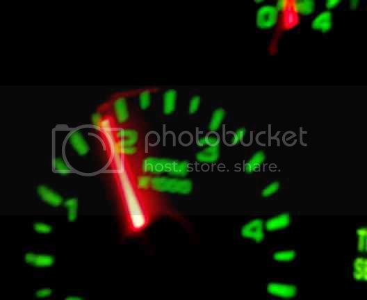

I really hope this fixed the issue. I'm not so much concerned on the staying awake part though. Ive got an assortment of music on the MP3 player for that cause. LOL. This video was the worst it has ever been. But when I was coming home from lubbock tx, last April it did it probly 80% of the trip, an insurance claim was definitely going through my head.LOL
