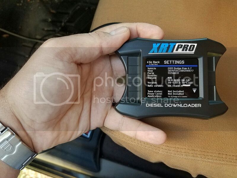

So it's been a long time since I've posted on this forum. Went to the Dodge world 5 years ago.
But that's besides the point. I have an xrt pro I bought new in Jan '12. Was wondering if it was able to work on a 2014. Have someone interested in buying it and don't want to sell it to him if it's not compatible.

should work as long as it's returned to stock, don't know how the xrt's are most of my dealing are with the mini, but it should be similar.
sootie
Oct 3, 2012
11,853
39
if it is is an original race tuner, it will only work up to 12 and an unlock code will be required for tuning an 11 or 12.
post up the version number. if it is a 1.0.3.x, it is a street unit. (can tune up to 14 with updates, may need high sulfer unlock) if the third digit is an 0,1 or 2 is it an original race tuner and is only good to 12.

My software version is 1.02.3

looks like its only good to 12. check the bottom of the screen when it is booting up to be sure.

yep, no way it will work. hit me up if i can help .
