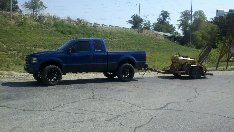

It actually was minimal, after I trimmed the inner fender well... and a small part of the fender. I was 17
-24 offset on the Hostages

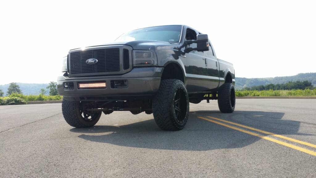

22x12 with -44 offset on a 4 inch lift. I had to trim the lower valence and they rub on the inner fender on the back of the wheel well. But minimal rubbing, IMO.

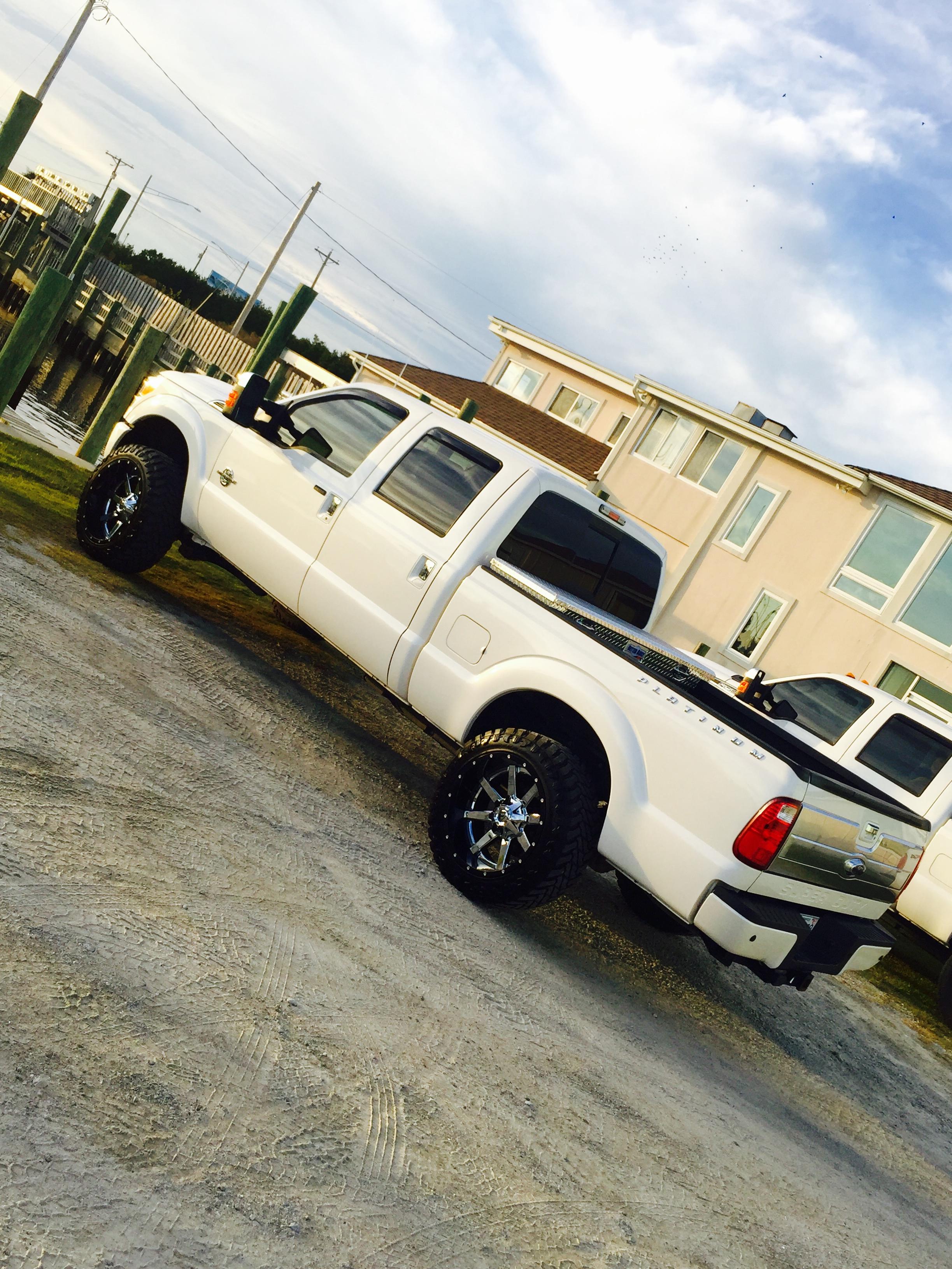

22x12s -44 offset on my leveled 6.7 with 35s. minimal trimming on the fenderwell and the bottom of the fender. had to do some trimming on the bumper bracket as well, but they came off of a leveled 6.0 and all he had to do was trim the plastic fenderwell

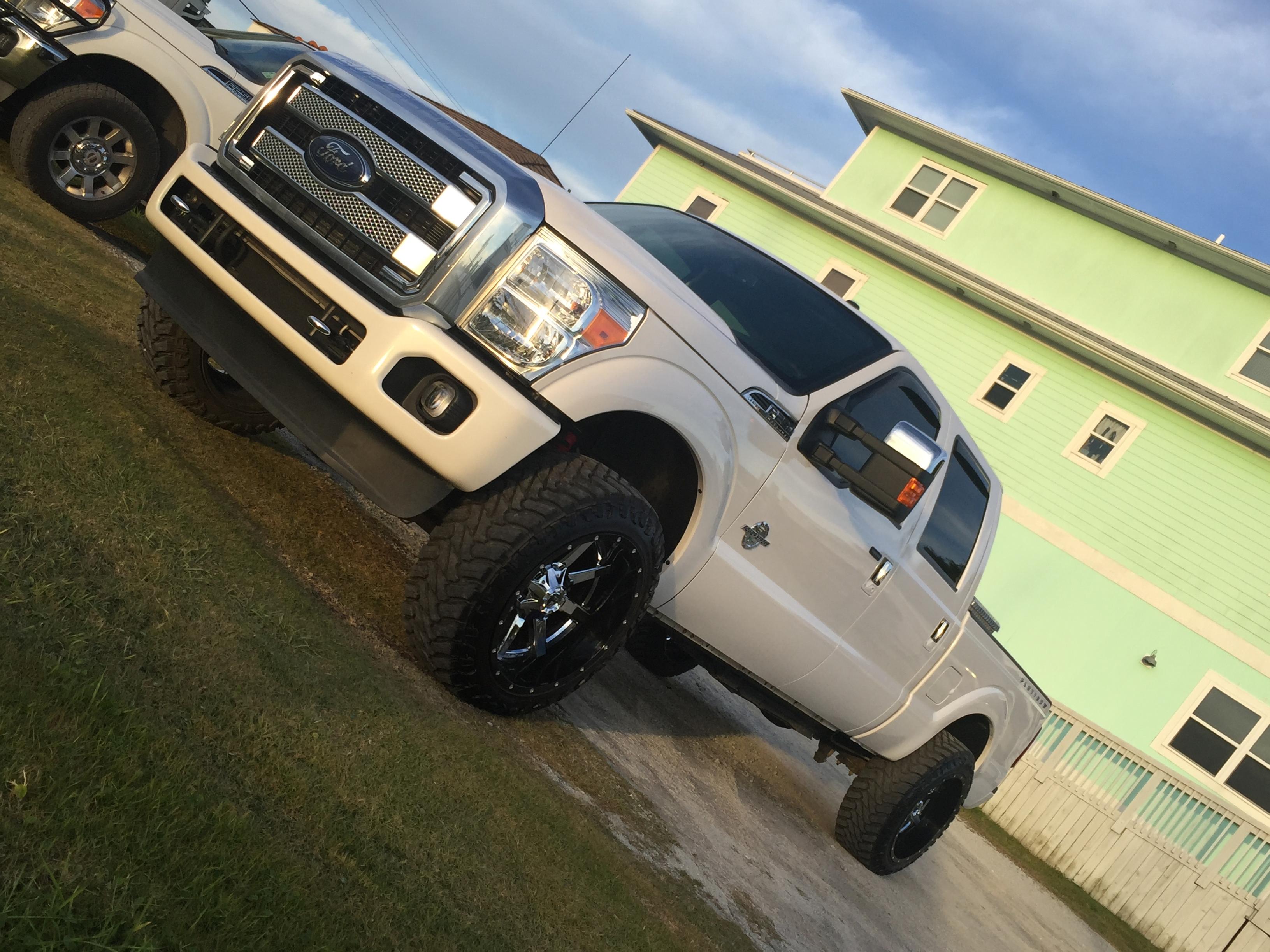

The ideal combination is 22x10 on 35x12.5x22 Tires. You can make the -24 offset fit but the -12 or even -18 will be even better.
Ive done this on multiple trucks, they make great daily drivers with this combo.
