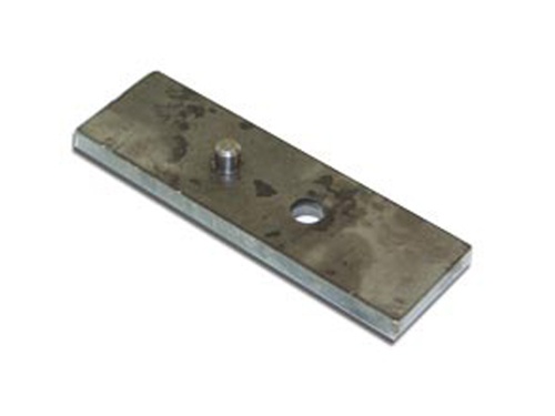

[QUOTE="blk350on20s, post: 334208, member: 1550"] Ok now i didnt see that block yet. I like that better. The add a leaf kit installs by popping out your old center pin, put a bolt through one of the offset holes and through the center pin hole on your leaf and bolt together. Place the center pin in the center hole and bolt to add a leaf. Now your block is moved forward/backward [/QUOTE]
